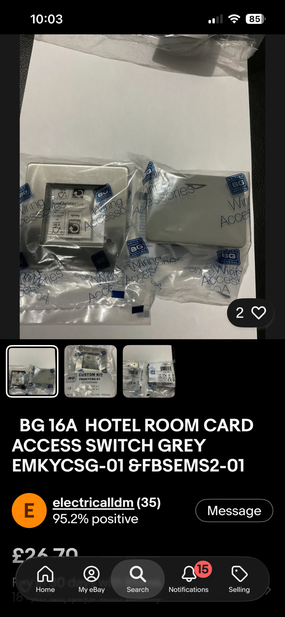

Ebay

How do you short circuit it? How do you open it? Do you take it off the wall?

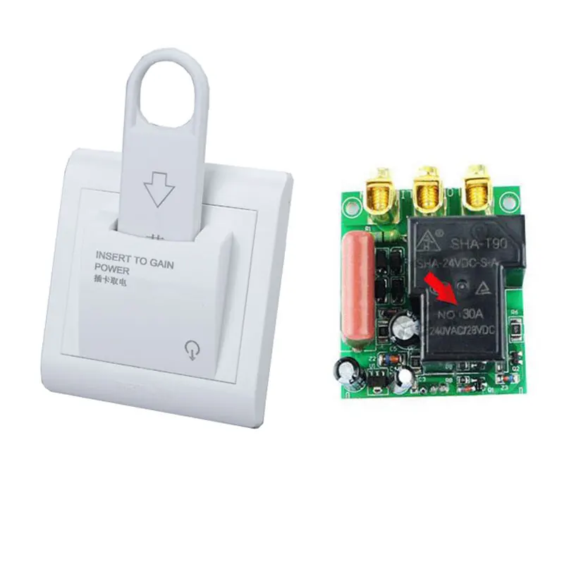

Although you have not posted a photo,
presumably it will be something like the item below.
From the diagram in the "Description" it would seem that the cover (of this unit) just pulls off to expose the screws attaching it to the wall.
Turn OFF the circuit breaker,
remove the cover,
unscrew the device,
connect Line-In and Line-Out.
(Disconnect and insulate the Neutral - to stop the device from drawing any current.)
Screw the device back on the wall,
replace cover
and
turn ON the circuit breaker.
If it is mounted on a wall-box,
you could just join the Line-In/Line-Out wires within that box,
(using appropriate connectors)
and
use a Blank Wall-Plate to cover the box.
(Note that any connector for the Line wires MUST be rated at least as high as the rating of the circuit breaker.)
