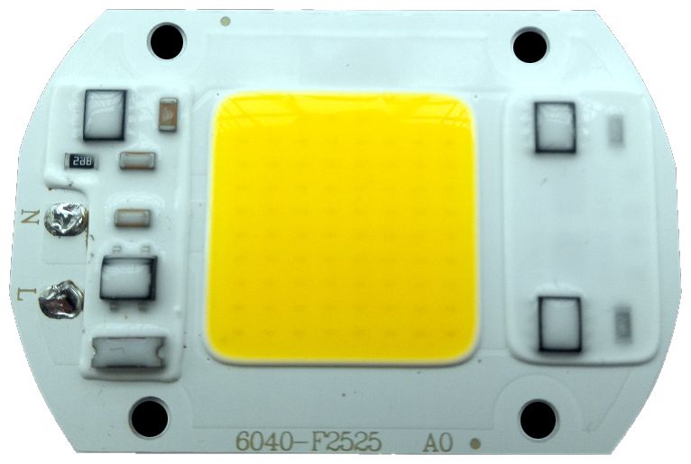

'driverless' meaning there is no separate power supply or driver,
So there is a driver albeit integral to the assembly of LED(s) and heatsink.
More accurate the lamp is direct on line ( as in no power supply module required between line and lamp )
Yes. This is a typical example:
While 'driverless' is not entirely accurate, it's just like many other terms which are used incorrectly all the time.

There are driver less LED lamps. They have two strings of about 80 LED elements and a resistor in series connected directly to the mains supply.One strin conducts on the positive half cycle and the secnd string conducts on the negative half cycles. A slightly better design replaces the resistor with a crude constant current device but that woudld be a driver.
Such a system obviously requires that the LED elements can tolerate the reverse potential during the non-conducting half-cycles. What is the typical maximum reverse voltage of an LED element?
Kind Regards, John
Typically the reverse breakdown voltage is at least 150% of the forward voltage. The conducting string acts as a voltage limiter and ( with a shared resistor ) the reverse voltage across the non conducting string is lower than the total of the EDIT reverse breakdown voltages
Fair enough. If they work, one has to assume that that is adequate!
The conducting string acts as a voltage limiter and ( with a shared resistor ) the reverse voltage across the non conducting string is lower than the total of the breakdown resistors/
[slight typo correction needed there, I think ]
Again, fair enough. Although I imagine that the voltage drop across that common resistor would be fairly small, by definition the total reverse voltage across the non-conducting string would be the same as the total forward voltage across the conducting string - so that, with that 150% 'leeway', that should be fine.
