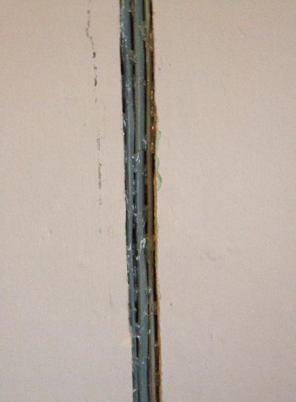

So this weekend I did two things:
I had an electrical engineer friend come to take a look at my work. His words "It's not how a pro might do it, but it's definitely safe and to regs" - This guy has done houses, wind farms, and now electric buses.
I also went to see new electrics installed in a Victorian era property. Four apartments. In many respects this guys work was messy and a bit lazy. It was good to see a "professional" job, and I feel I'm doing a pretty well relatively. (in many ways better)
Research, and feedback. I feel a lot better about this now.
I also did some more hot-gluing and to be entirely frank it's absolutely fantastic for holding cables in a stone chase.
Two 2.5mm and a 1.5mm cable in a chase... this is a wall with some very crumbly old plaster and very old uneven brickwork underneath.
I know hot glue isn't a popular method but I don't need something fancy, I just need something that works, and hot glue works very very well!
This bloke just ignores every bit of advice, isn't interested in professional standards, and will do it his way regardless.
Shame, I thought he might take on board our advice.
