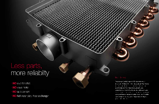

The marketing of Intergas boilers does make for interesting reading.
from Builders Depot site
""3 Years parts and labour warranty as standard and this can be extended to 7 years""
how much does the extra 4 years cost.
""Only 12 components, including 4 moving parts""
How does one decide whether an item is "a component" or is not "a component"
There are at least 11 "U" bends with at least 22 soldered ( or maybe now brazed ) joints as part of the heat exchanger.
