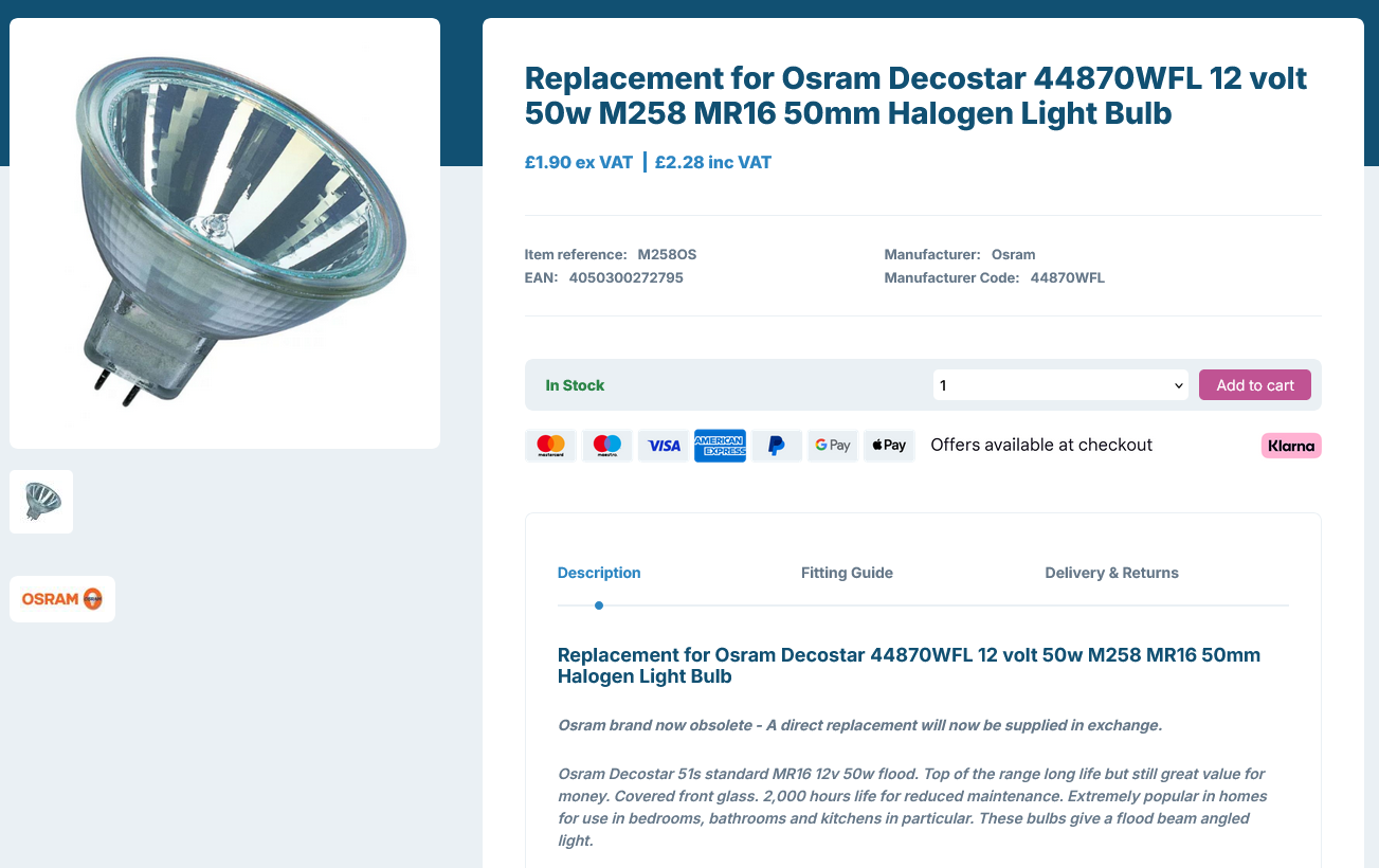

I would buy one G5.3 bulb and try it, that is the simplest option. With a tungsten bulb, the thicker the filament wire, the longer it will last, so 12 volts lasted longer than 230 volts. But with LED, all the advantage of low voltage is lost, except where forced to fit them in bathrooms.
But no harm should result in fitting a 5 watt bulbs on a 20 watt minium supply other than it not working.
We have 4 devices which can power G5.3 base 12 volt bulbs.
1) Toroidal transformer, this will allow use of LED with no changes.
2) Electronic transformer
A) With no lower limit, in the main same as toroidal transformer but could turn into a transmitter, but unlikely.
B) With lower limit, rearranging so fewer transformers so more load on those left, may be possible to make them work.
3) Driver this is a poor name, as it covers current regulated (AC and DC) and voltage regulated normally DC, but in the main it refers to voltage regulated DC, in real terms there is no difference to 2A other than less likely to turn into a transmitter.
These all cost money, so the other method is moving from extra low voltage (12 volt) to low voltage (230 volt AC) there are adaptors
The first has no junction box, and an EICR would likely list them as a fault, the second with junction box, far better, but both do the same thing. But also the whole unit
can cost less than the adaptor, so it is hard to advise which route to take. The lack of earths can be seen as a problem, as often the 12 volt versions were wired without earth wires, so really new cables should be pulled through, but often they are not.
I am trying to point out that it can be done super cheap, or super safe, and you have to decide what road to take.
