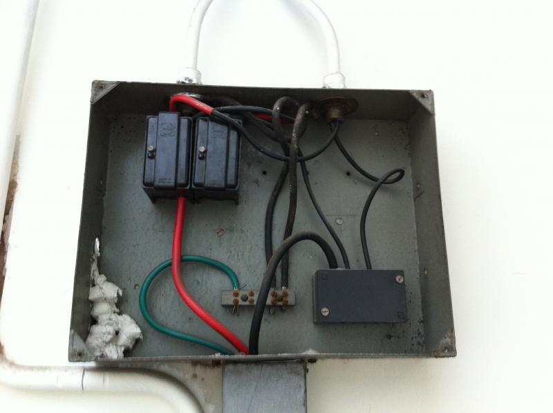

Outside on the landing, just a floating fuseholder (60A) in a metal box (at about 2.2m height) which also contains another fuseholder for the other flat on that floor and the neutral service block. Standard supply for this type of building. SP Energy Networks don't have a problem with it and tell you to use the MICC sheath for the earth :shock: as long as it provides a good path to earth at the 3-phase incomer by the front door. They will not upgrade a single supply, only whole tenements (lots of zeros). If their steel conduit between incomer and cutout boxes is REALLY rotten then there is a case to be made for them to re-wire FOC.
Will get pics if i remember, there are many thousands with the same setup round here (not my flat though. . . )
This is the cutout for the flat, a bit different to normal, usually the fueseholders are floating and the earth is from the conduit/trunking only (I know...) Seeing as they have provided a proper earth in the box I will run a new cable from here to the CU.
Note the (failed) attempt to fill the knockout on the left with filler! and the (usual) poor standard of the door entry conduit install.
Surely running a new cable is preferable to putting a BS951 clamp onto MICC!?
Where does the green wire in the metal box go?
As surely this is a earth, and where does the two black wires in the earth block go?
The green wire is the suppliers TN-S earth.
Each black wire goes to one of the pyros. They go to a toothed washer and smooth washer contraption that you put the wire into and kind of crimp shut.
It then gets clamped between the enclosure and the locknut. It was like a forerunner to the SWA monacle.

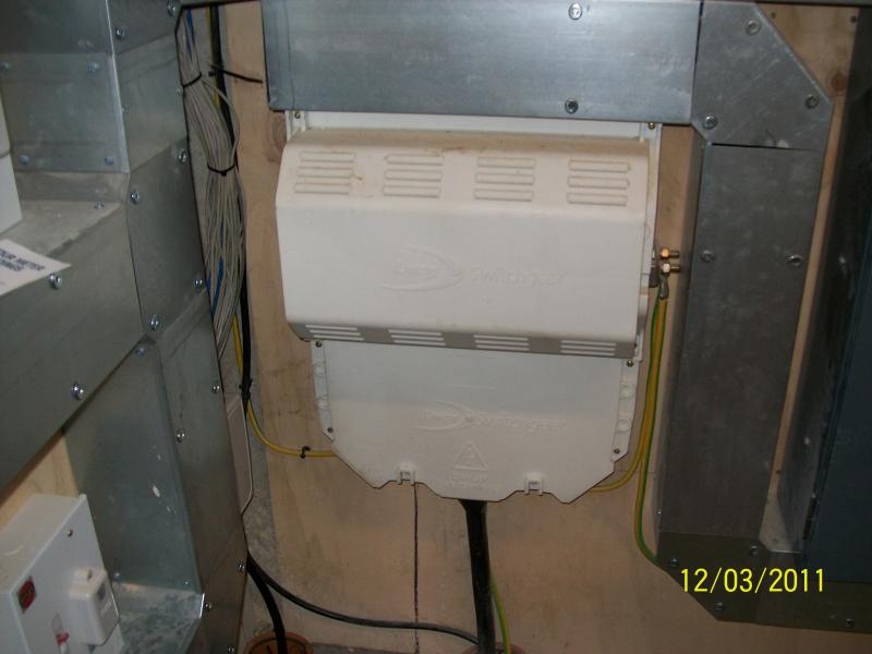

In one newly built twenty-teens apartment block, there is a big three phase fused incomer in the ground floor meter room, feeding a ryefield box alongside, complete with a 100amp fuse for each flat.
From that, each flat's meter is fed through steel trunking, and for good measure, a Wylex Switchfuse unit sits between each meter, and the flat being supplied. The consumer unit in the flat is a modern Wylex 17th edition board. The earthing is PME/TNCS, taken from a thick metal bar sticking out of the right hand side of the main fused incomer unit.
Are they 300A per phase? Supply cable looks fairly thin, but there's not a lot to base the scale on.
