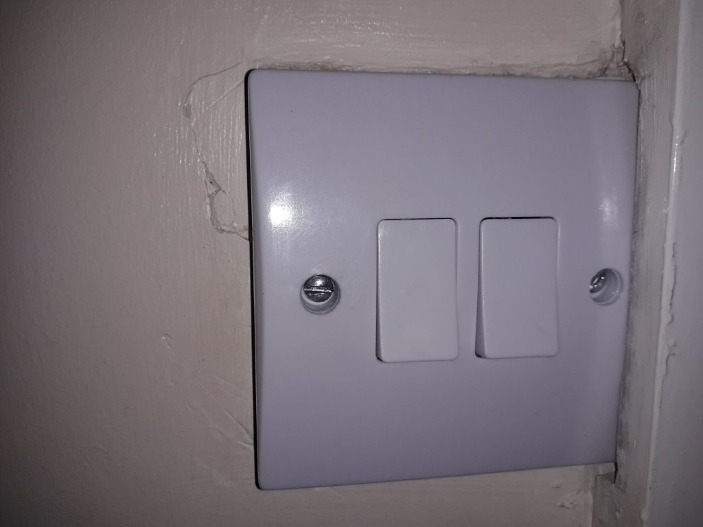

Now that I have learnt how to change bulb holders, things go to my head and I changed all the switches in my house. It was all going well till I met my challenge. This particular switch is wedged into the door frame a little.
I removed the old screw and put in the new screw (that came with the new switch) and it is not a firm fit and the switch is now loose. I have tried inserting a fatter head screwdriver/ holding with a plier and tried to unscrew but got nowhere. I have a feeling both screws have the same symptom. What are my options now?

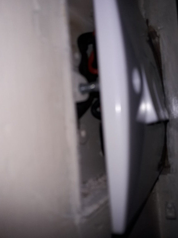

I did. Didn't work. :cry: If I pull any harder, the box will come off.
If you can push the switch far enough against the wall to expose the back of the screw head, I would try pincers or a claw hammer to put force on the screw while trying to unscrew it.
But ultimately you may have to resort to destructive methods of removal and then replace the whole box and switch. Unfortunately it seems the previous installer was a bit of a bodger to say the least (looks like a surface patress embedded in the wall to me), so re-doing it properly may be more effort than it would normally be.
It's probably spinning because the spline on the brass threaded insert has turned in the horrible. brittle, plastic back box. Once it does that all you can really do is grasp the top of the screw and try to pull the insert free without actually breaking the horrible, brittle, plasticky back box. Once it's out you can, hopefully, hold the insert with a pair of pliers and unscrew the screw. Providing the back box hasn't broken you can reinsert the insert and stick it back with some superglue. Two problems that might arise are that the thread might be knackered so the screw will only turn the insert round an round again or you could get superglue inside the insert on to the threads which will only achieve the same result.
As pete50 above says, the knurled thread insert is spinning so the box is likely useless, its the wrong box anyway.
Push the switch back, the screws are Brass cut the heads off with pliers, remove and fit either a flushed in box or if you must, another new surface box, refit switch and jobs a good un

Yes, the box is plastic. There are also no earth wires in this particular switch.

You could try snipping the heads off the screws (best wear goggles I suppose) so you can move the faceplate out of the way to have a look at whats going on.
This may be awkward as the faceplate seems to slightly tuck into the architrave.
If you can pull out the screws and the brass threads you may be able to bodge around and salvage the box.
All in all though, the best solution is to be a bit destructive, cut that box out, fit a new box - this time move it a bit to the left to avoid the faceplate being too near to the architrave.

It seems I screwed up ( excuse the punn ) by using the new screw that came with the switch. I should have just used the old screw that I unscrewed from the old switch. Who knew this would cause problems. I tell you, both old and new screws look exactly the same!
