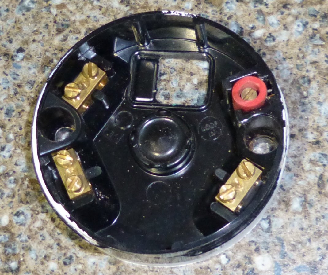

There is an E there followed by what looks like an O but
what difference does it make?
The terminals are all the same except one is a single.
FFS don't confuse the OP any further.
Electrically, none.
The fact that it is an earth terminal, marked as E for earth and has lives going to it is just plain poor.
When it is replaced it should be corrected as a matter of course as some E terminals are not fully insulated.
Here is what one of those Ashley roses should look like, the single terminal is marked loop in and has extra insulation in the form of a red plastic tube. The terminal is also much more enclosed by the plastic moulding. This will of course have no effect on the OPs fault.

Loking at the state of the ceiling rose, i wonder if water has leaked through, gone in the lampholder and simply blown the live wire off the lampholder terminal, causing the light to stop working

Using a multimeter I am getting no reading from either of the tests Echo the Husky has suggested.
OK. That suggests a break in the supply to that light fitting, most probably at the previous fitting, wherever that is.
As (I think Echo) said, it is best to start looking at the nearest fitting. Which one it will be depends on how the circuit was originally cabled.
The 2 nearest are the lounge and the upstairs light, how do I know which is the previous light?
