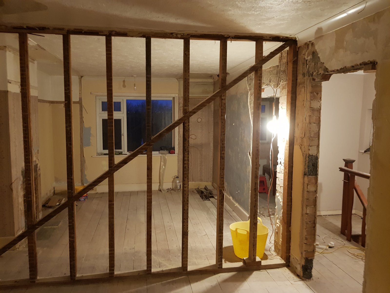

Following my queries on how to build a new wall, I have also found myself replacing the old slate and plaster with new boards.
I cleaned up the old stuff and uncovered the studs. Got few questions:
1) Can I make the wall stronger adding some horizontal stiffness between the studs? and how?
2) When installing new plasterboard as the room is 2500mm ceiling height and board is only 2400mm, Where I have to join them ( top or bottom ) and how small can the remaining board? Do I have to cut at 2200mm and add a 300mm piece?
3) Deflection? Do I have to leave some gap on the floor? Do I have to leave some gap on the ceiling
4) What are the best screw for wood installation? Size/lengths and material
5) Do you usually hang ceiling or wall first?
6) Plasterboard brand and type. I would use a 15mm for wall to make it more sturdy and 12.5mm for ceiling. What brand you suggest and what model.

1) You can stiffen a stud wall to an extent by adding noggins between the studs
2) Because almost all generally available PB sheets are metric (I.e 2400 x 1200 not 2440 x 1229, or 8 x 4ft) and old (pre-1980 or so) stud walls are all going to be set out in Imperial measures (as we only metricated in the 1970s) quite probably on 16 or 24 inch centres, you may well need to add laths to the studs to cover the shortfall if using metric boards. Put the gap at the bottom of the wall rather than the top, try to keep your PB rips at 250 to 300mm minimum and remember to leave a gap of 10 to 30mm between the bottom PB and the floor. That is to prevent water wicking into the board and will be covered by the skirting in most cases
3) Ceiling goes in first. Wall boards butt up to it to help carry the edge of the ceiling boards
4) Installing what? PB onto wood? Look for drywall screws, 35 to 45mm, coarse thread
5) See above
6) 12mm will do for domestic. 15mm more common if installing sound block board and in commercial builds. All commercially available brands such as Gypric, Lafarge, etc are much of a muchness IMHO (although I'm a joiner - a dry liner might disagree)

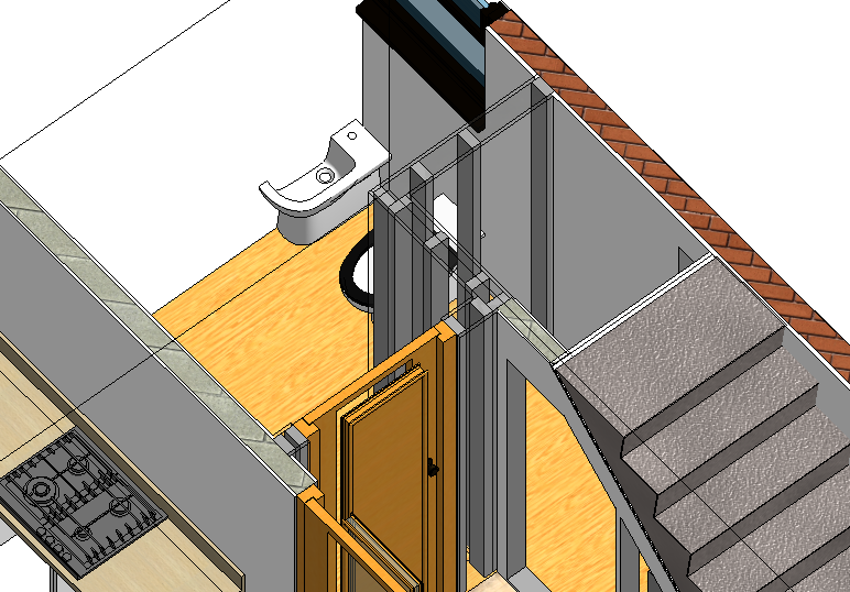

How would you place the stud on a Z space scenario. I have attached a drawing but look like too many studs for me. Please advise where I'm wrong.
Studs are in red color
Nothing wrong with quantity but position of a couple means you have nothing to fix plasterboard too in the internal corners .
