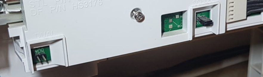

Does anyone know what these two pins do? Looks a bit odd.
It says 'DUAL' above them - upside down.

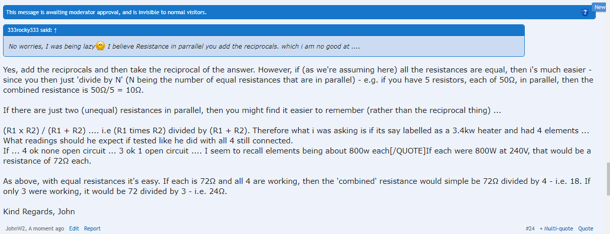

No worries, I was being lazy:) I believe Resistance in parrallel you add the reciprocals. which i am no good at ....
Yes, add the reciprocals and then take the reciprocal of the answer. However, if (as we're assuming here) all the resistances are equal, then i's much easier - since you then just 'divide by N' (N being the number of equal resistances that are in parallel) - e.g. if you have 5 resistors, each of 50Ω, in parallel, then the combined resistance is 50Ω/5 = 10Ω.
If there are just two (unequal) resistances in parallel, then you might find it easier to remember (rather than the reciprocal thing) ...
(R1 x R2) / (R1 + R2) .... i.e (R1 times R2) divided by (R1 + R2). Therefore what i was asking is if its say labelled as a 3.4kw heater and had 4 elements ... What readings should he expect if tested like he did with all 4 still connected.
If ... 4 ok none open circuit ... 3 ok 1 open circuit .... I seem to recall elements being about 800w each[/QUOTE]If each were 800W at 240V, that would be a resistance of 72Ω each.
As above, with equal resistances it's easy. If each is 72Ω and all 4 are working, then the 'combined' resistance would simple be 72Ω divided by 4 - i.e. 18. If only 3 were working, it would be 72 divided by 3 - i.e. 24Ω.
Kind Regards, John

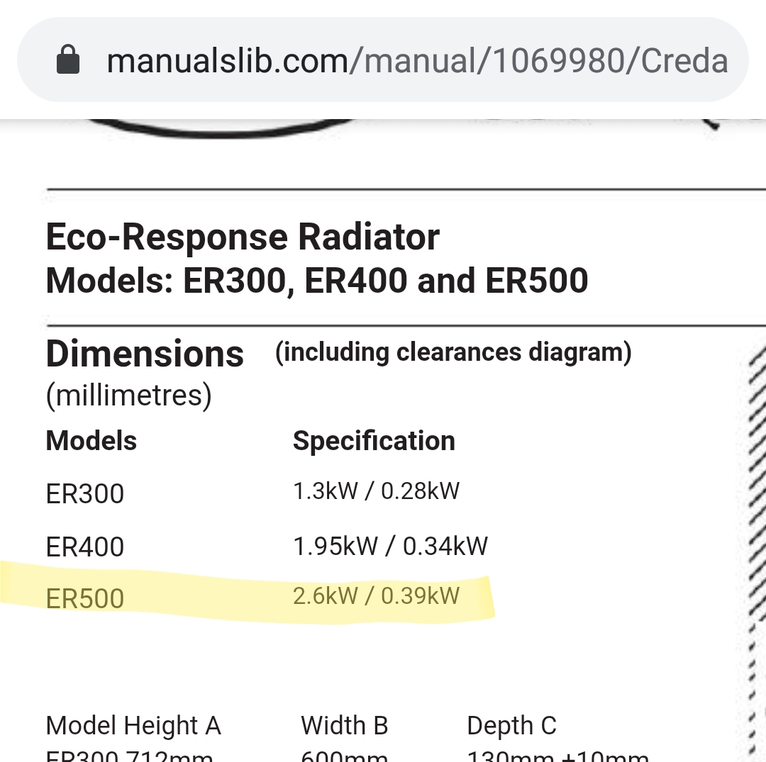

Page 1 of manual:
What does the 0.39kW mean?
Anyway, 2.6kW with four elements is 0.65kW each = 88Ω / 4 = 22Ω.

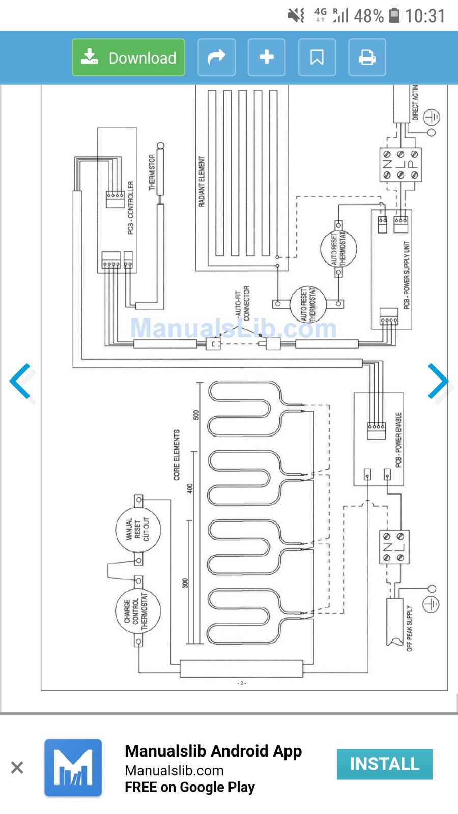

Looking at the ops previous thread it appears to have 4 elements

The off peak storage heater is 2.6kw.
The separate peak "top up" radiant panel is 0.39kw (this kicks in during the day as & when needed to maintain temperature when the bricks lose heat). The 0.39kw panel works fine, it's just the off peak that isn't producing heat.
Rocky is right, it has 4 elements, I thought it only had 3, so I only tested 3. The precise reading for each was fairly stable on 22.7ohms. I'll test the 4th when I'm home tomorrow.
Based on what's being said I'm still thinking a fault with the off peak part of the control module where it's got power to it, but a fault is preventing it sending anything out to the elements? 0.39kw peak panel works off same control module.
