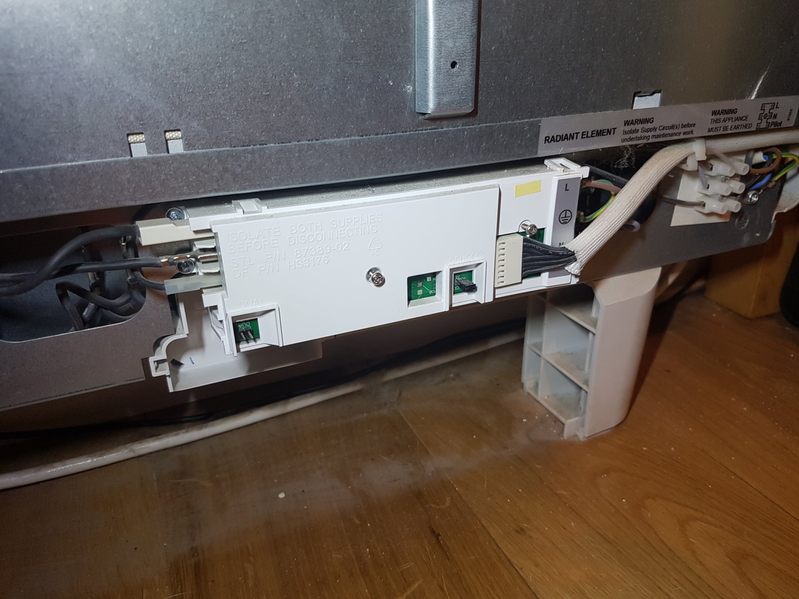

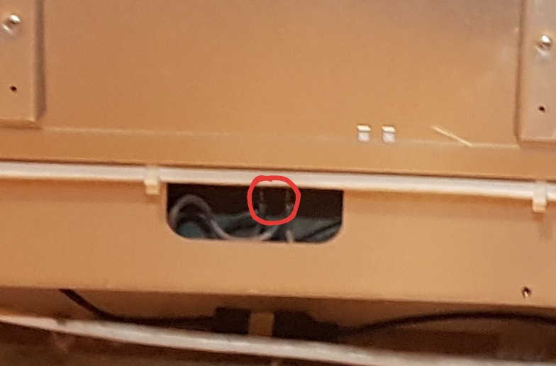

Posted a while back about a faulty storage heater. I've replaced the thermostat and cut off, but it's still not working.
I tested with a multimeter, there's power going into the control module (both peak and off peak supplies), but I can't get a reading on the cables that attach to the off peak elements out of the control module.
Presumably this means there's power going into the module, but nothing coming out, therefore faulty control module?

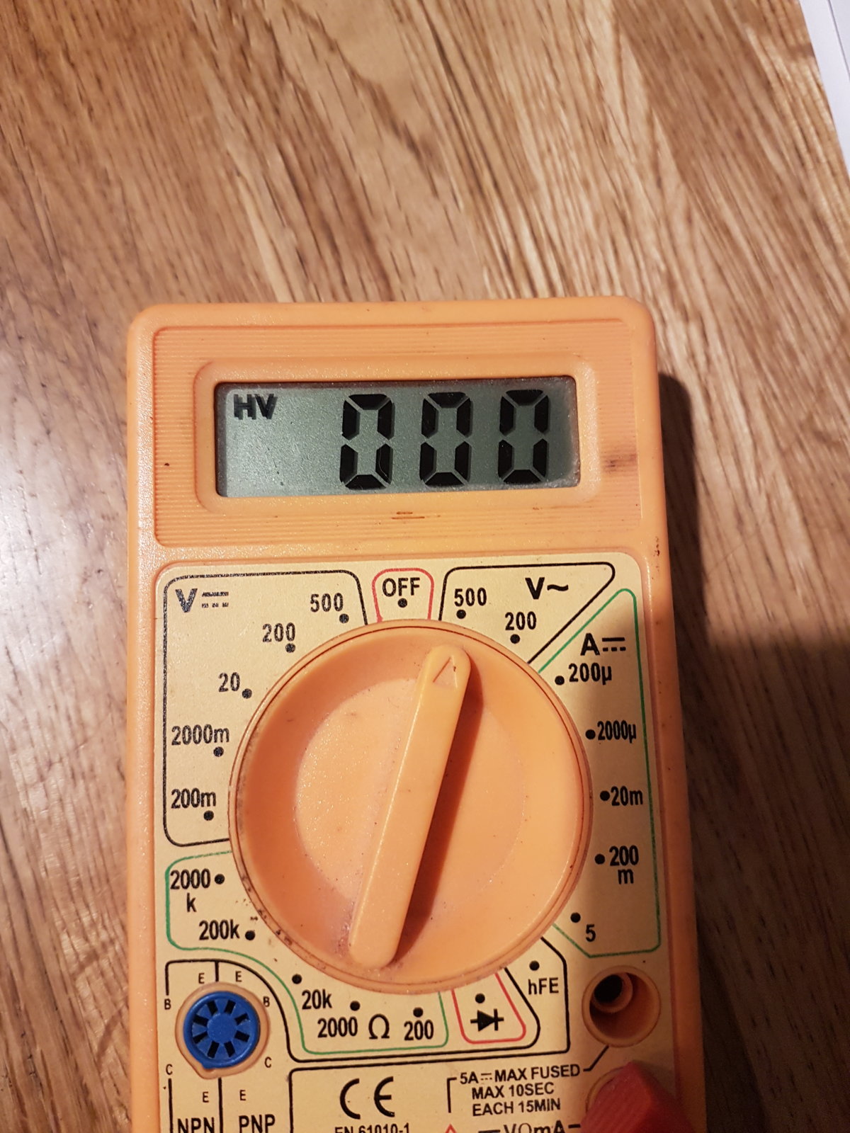

How are you measuring the elements? What range on your meter?
Same setting to check power to the control module. Should I be using a different setting?

Anyway, stat replaced but it's still not heating up overnight. There's off peak power to the control module, but no reading out to the elements, so I suspect failed control module (£110). I'll do a continuity test on the elements, what setting is that on this multimeter (above), the one at 5 o'clock position? Or what else can I do go test control module functionality? I looked at the connections, all appear to be ok.

Continuity uses the OHMS setting, this looks like between 6 and 9 oclock on your meter
The 200 setting i quess will do

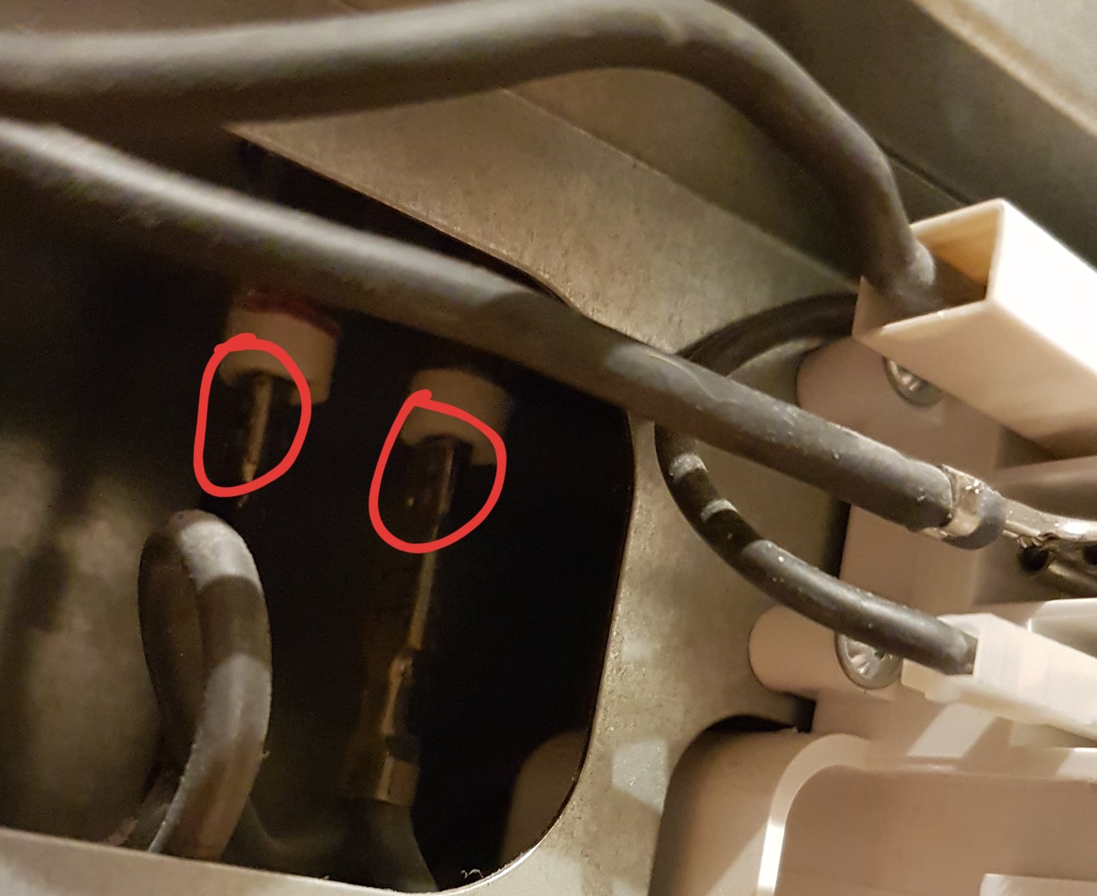

Thanks. Set the meter to that, applied points to the cables attached to heating elements. Getting a reading of 22-23 in all 3 elements.
Not sure how your heaters wired as it has a control module, but with a BASIC heater all 3 elements are in parallel, therefore all 3 readings would be the same with the elements connected.
I would suggest pulling 1 wire of each element then testing through the element terminals, the chances of all 3 elements failing is slim, i would say their not the problem.
If you know the total wattage of the heater and it has 3 elements, then simple ohms law will give you the expected ohm reading of each element
Not sure how your heaters wired as it has a control module, but with a BASIC heater all 3 elements are in parallel, therefore all 3 readings would be the same with the elements connected..... If you know the total wattage of the heater and it has 3 elements, then simple ohms law will give you the expected ohm reading of each element
