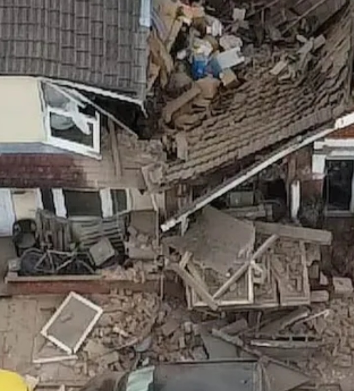

thoughts on this house collapse?
The report claims an explosion but theres no evidence for an explosion.
Debris isn't scattered far and wide in the street.
Maybe the reporter is suggesting it was a gas explosion but theres no burning or fire crews response for burning which is sometimes the case with gas explosions.
Lack of fire doesn't rule out a gas explosion but maybe it was structural: on the left hand side the party wall is missing - the party wall on the RH side is intact.
As above, going into the front door or getting out of bed & using a switch/igniter has happened in a few incidents.

It wasn't an explosion, it was a more gradual collapse - according to reports. Next heard cracking noises and saw big cracks appearing the walls, before it all came down, so a structural fault of some sort.

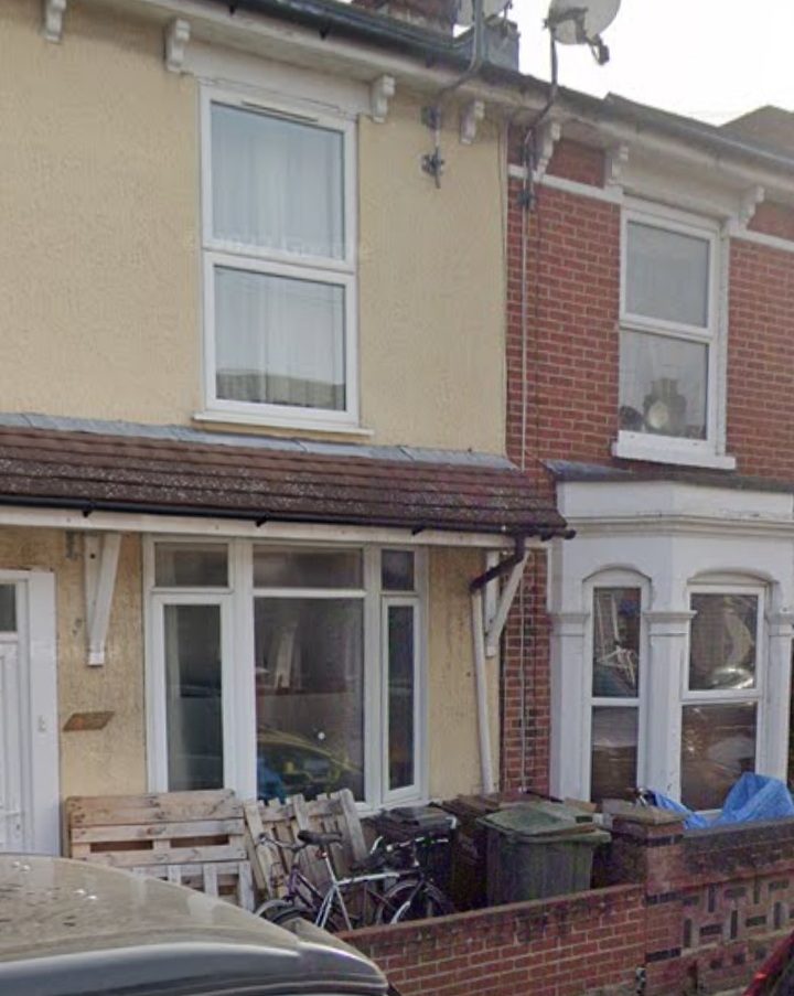

No.23 looks like it's been opened up a bit (2016):
But No.25 looks quite solid (2014):
Not far from where we are, 15 miles. Local news had no reports of an explosion. I was trying to see if there is a skip in the front under all that debris. Going open plan and removing the supporting wall perhaps?
I don't believe so, from the pictures I've seen.
The pallets in the front yard of 23 look suspicious, but they are in the same position on Street view!:
There was mention in the news media that works had been done to the property regarding alteration to the basement .
