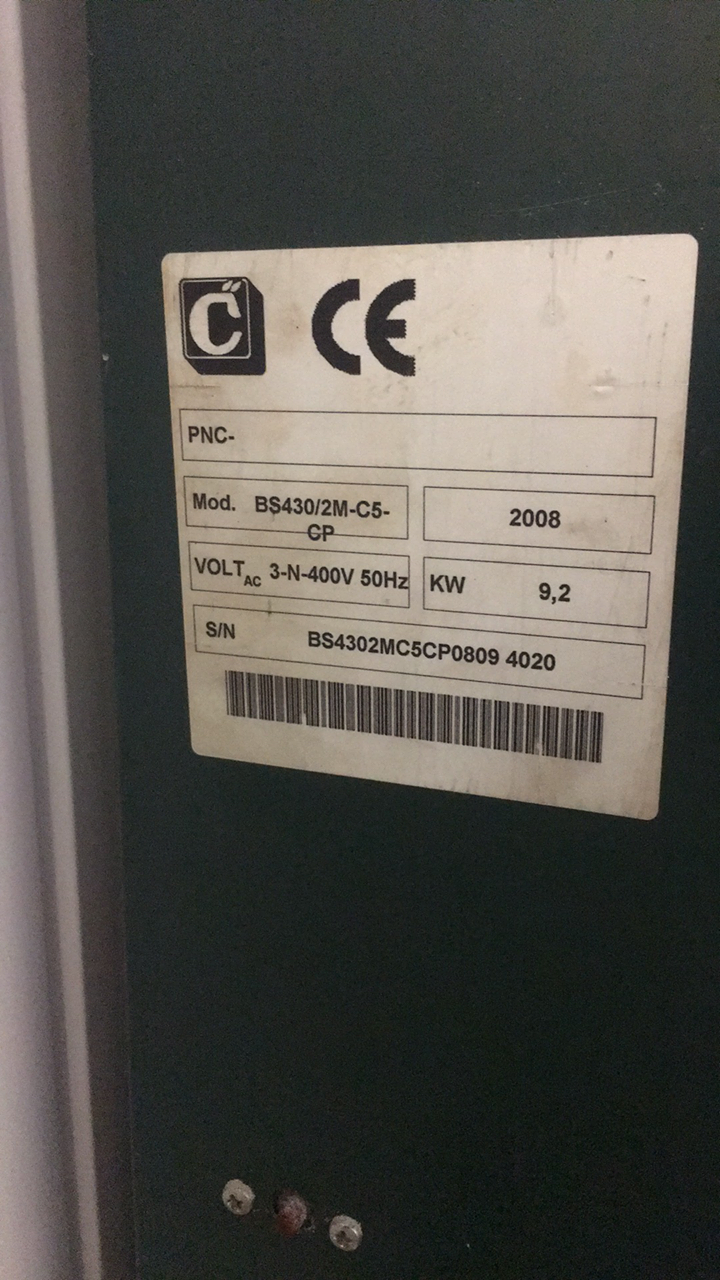

Hi guys I’ve been offered a 3 phase pizza oven at a decent price and was going to put it in the garage.
questions....
Is it a big/expensive job to enable the use of a 3phase appliance?
Can you convert it from 3 to single phase?
many thanks
Depends on what it has in the way of elements & possibly a fan, the elements should convert to single phase
Thanks for the input gents.
9.2kw is the output.
I’ve attached the spec plate here.

As others have said, it might be possible to reconfigure this to a single phase 230V supply (as can be done with alot of continental Hobs).
We would really need to see a schematic diagram of the oven to see if this is possible. If the elements are 400V then no chance, if 230V it may be possible. Even if the elements are 230V it isnt simply as simple as connecting the three 'lives' to a single phase supply - that would almost certainly result in a serverly overloaded internal neutral
At 9.2kW its going to pull around 40A from a single phase supply (broadly the same as a 'large' electric shower). In other words, if your incoming supply is 60A its going to use 66% of the available capacity. However, like all ovens, once its upto temperature it will cycle on & off only taking that 40A in short bursts.

Thanks again chaps all appreciated. I'm struggling to make a decision on this and do not think I will be able to obtain any kind of wire diagram.
I've had a look for replacement elements and they are 230v https://www.ascateringsupplies.com/...x-540mm-cuppone-bs430-2m-bscp-pizza-oven.html
Yes John the temp can be controlled top and bottom. Its potentially a decent oven for bread if we can convert and work within the height restrictions.
