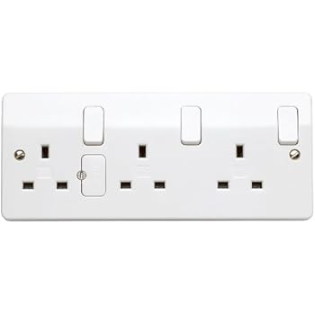

OK, so I will probably do what everybody else does have have a normal socket with an extension ... but, are there options bigger than these ....

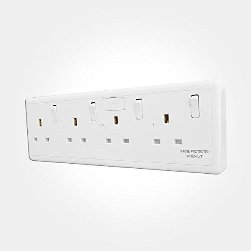

that are not just converters, like these
Is it about how much one socket can handle or something? Ideally, behind my TV I should have at least 8 sockets (TV, bluray, set top box, xbox, nowtv, surround amp, stereo amp, record player - but a couple of spares might be sensible). I usually make do with a double connected to a couple of extension sockets, but it would be much neater to have fitted wall sockets.
I guess the only reason not to do this is if you decide you want to move your TV..... but I can't see that happening.
There's a number of reasons, but realistically, if you want 8 sockets, 4 twins is the best way to do it.
You'll notice that on both of those sockets one of the outlets is fused (maybe more than one on that nasty converta). That's hardly an ideal arrangement.
Partly - note that all 3 way and above items have a fuse in the front plate, limiting the total load to 13A.
The other reason is lack of demand - very few people would want a 6 or 8 way item permanently in the wall.

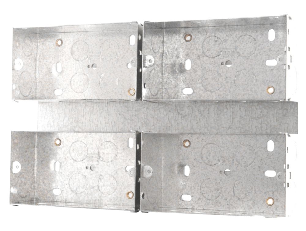

I did ours in pairs with 50mm between, or you can go for one of these:
https://www.screwfix.com/p/british-general-mounting-box-steel/2034f
ae235
Other makes, and other combinations, of media plates are available.
Or, basically, if you want to have 8 flush sockets, install 8 flush sockets.
B-A-S- where's that faceplate from? I've used some of the BG 4 x 2g plates in my wiring scheme and got cursed at by the plasterer (and the bloke doing the boarding) for giving them nightmares- that little puppy would have solved many problems (and stlll can- the House of Pain is nowhere near finished) :)
