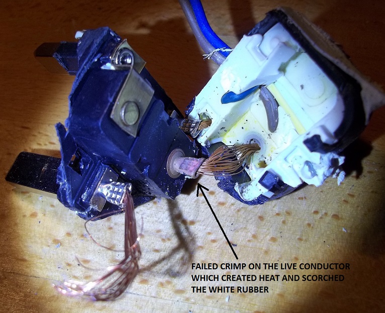

I have just replaced the moulded on plug on a neighbour's 2kW heater after she noticed the plug was getting hot.
Dissecting the plug identified the fault.

The contact area is the same, I think you are thinking about the CSA of the copper in the pin. But even with the reduced CSA - it's still a solid lump of copper with considerably higher CSA than the cable that will go into the plug.
The only problem with BS1363 plugs is the fuse in the plug, which will heat up in normal use and could cause damage to the plug and socket if it was used at full load for an extended period.
But they aren't supposed to do that.

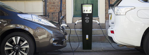

It seems councils will fit charging points, which means it does comply with safety requirements and there is a reduced trip hazard.
It seems to get people to go electric 75% of installation cost is funded by government, however that does mean you can't DIY. But cost it seems is capped at £500. As to what is different with this
and a standard 13A outlet I fail to see, however I note although vehicles say 3 kW the socket spec says 2 kW. This
is rated 3 kW the charge cable is clearly hard wired in. 13A socket is just to use lawn mower off same supply.

View attachment 154710 It seems councils will fit charging points, which means it does comply with safety requirements and there is a reduced trip hazard.
Non-EV owners are going to become very unhappy if parking spaces in their street disappear because they are, in effect, reserved for EVs.
