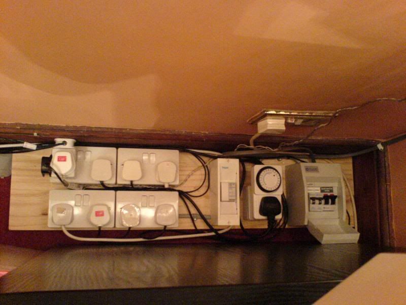

I decorate a couple of houses, this is the main control board for one:

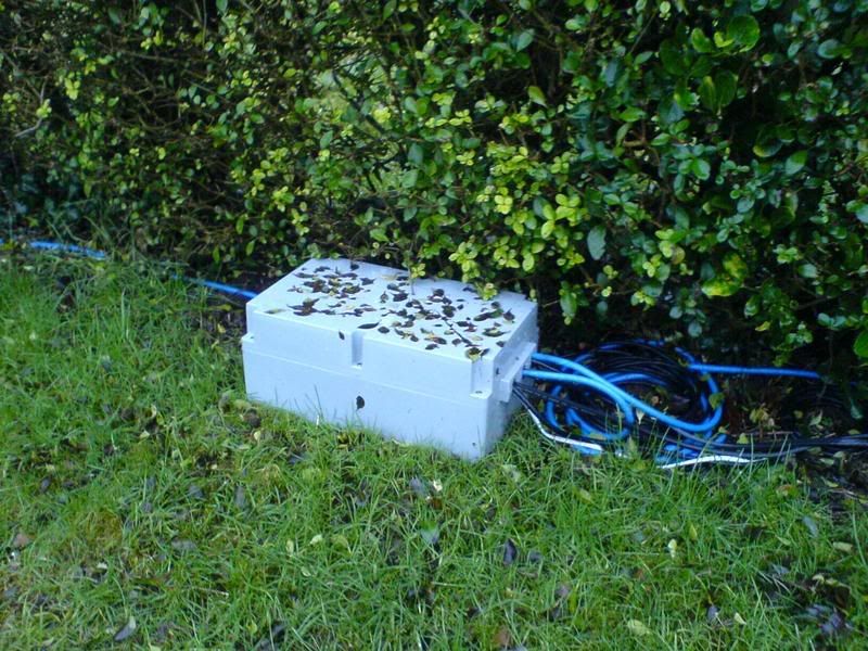

OK not quite what you want but i also use these outside for the trailing sockets/plugs etc:
Which is more like what you need i think, you can easily fit two 4-gang power strips inside and a few transformers too, these can be purchased at B&Q and will be with the christmas stuff when they put it out. If thats not what your looking for give us a little more information, you don't say if you want this box/board to go inside or outside, once we know a little more I'm sure we can find or advise you on what you need.
