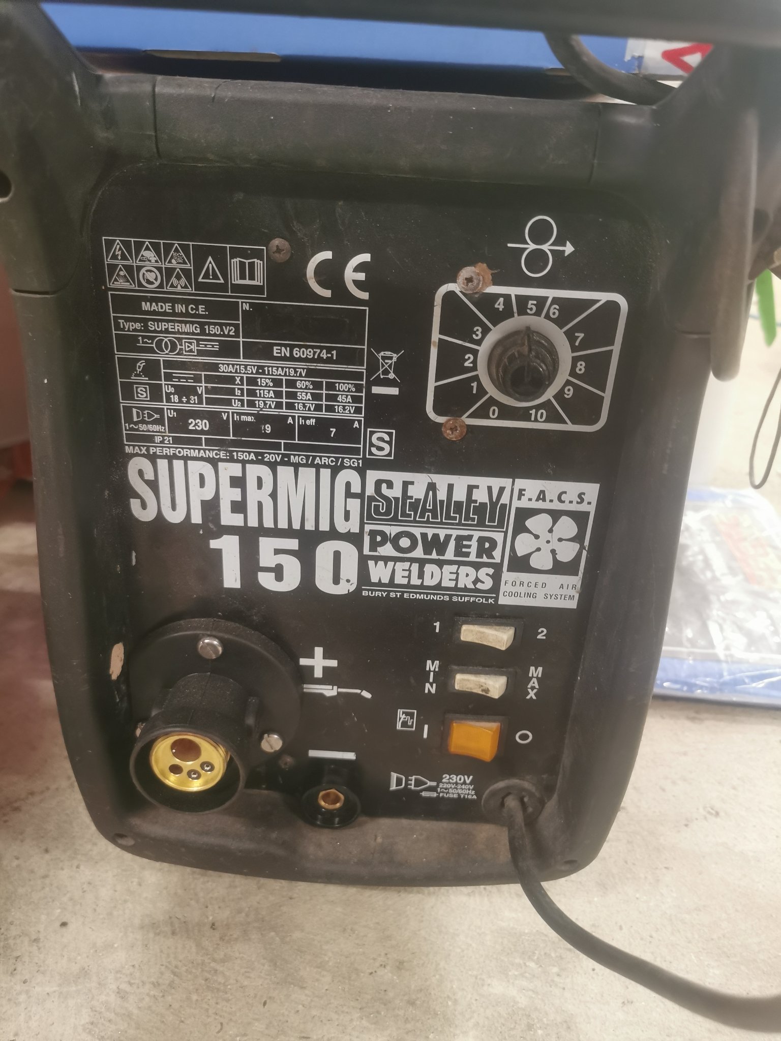

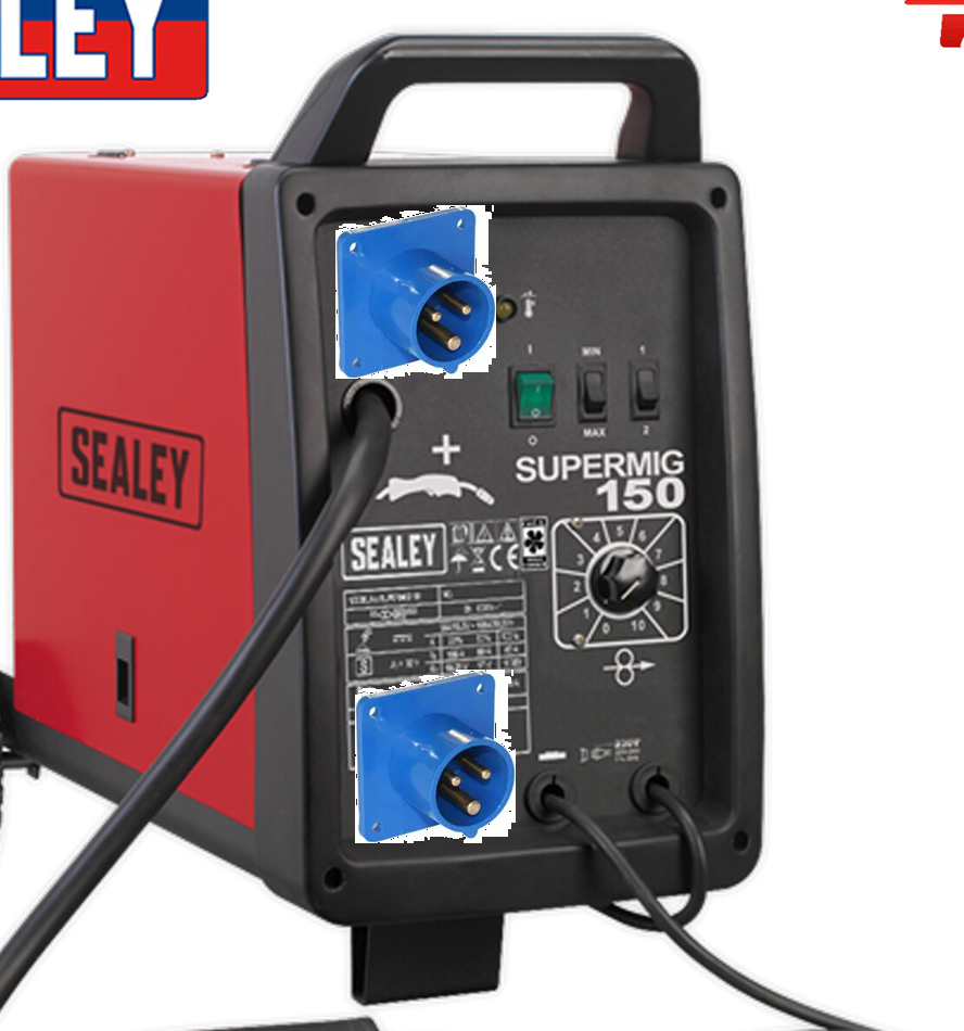

So I've been back into the garage having listened to what's been said.
That's my welder, looking at it again I suspect I can squeeze a commando inlet on the right between the wire feed knob and the 1/2 setting switch.
Ill need to get an inlet and see.

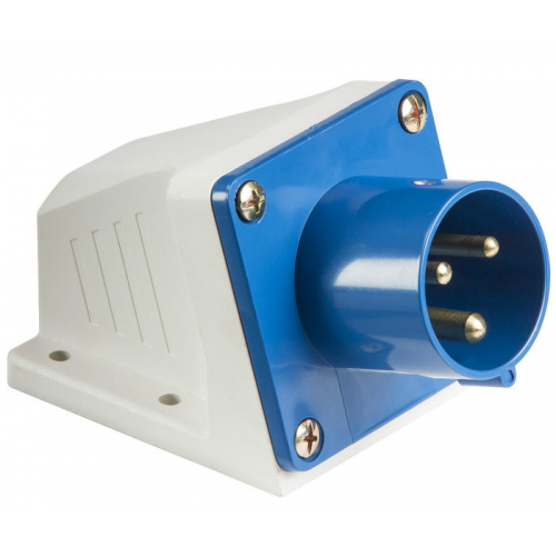

Would this commando panel socket be suitable? Or should I go with a 32a panel socket, albeit I'd assume the 16a socket has been tested to have a safety margin over 16a?
You require an male or inlet, such as this panel mount
or this surface mount
Bear in mind when positioning it; the socket (AKA coupler) cover will have to open to 180º for the panel mount version and that space will have to be allowed for.
Sorry yes the widow maker principle.
It is only a "widow maker" if a live side can be accessed whilst live - that is if one of those shown is energised, if it is not live it needs to be plugged into a mating part to make it live.
In other words, any extension you use will only become a widow maker if you have a plug at both ends in order to plug one end in and the other end becomes live.
