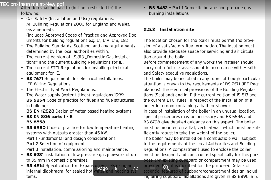

This is from a post 2012 vaillant ecotec...

The following comes from a Vailant EcoTec plus installation manual.
'The boiler is supplied for connection to 230 V, 50Hz supply fused at 3A rating. Connection to the mains supply shall be made via a 3 pin plug to an unswitched shuttered socket, both complying with the requirements of BS1363. (Alternatively, connection may be made via a 3A fused double pole isolator having a contact opening of at least 3mm in all poles and supplying the boiler and all controllers only). The point of connection to the mains supply must allow complete electrical isolation of the boiler and its ancillary controllers. It should be readily accessible and adjacent to the boiler. A 3 core flexible cord according to BS6500 tables 6,8 or 16 (3 x 0.75mm² to 3 x 1.5mm²) should be used.......'

The following comes from a Vailant EcoTec plus installation manual ...
We already know that boiler makers say that - that is not in dispute.
Quoting from that manual does not advance our knowledge, it does not explain why they say that.
Do they say it because the UK gas regulations require it?
Or do they say it because they have made a product which is not safe to use on a supply fused at more than 3A?
If the latter, what happens in countries where FCUs and fused plugs are not used?. That is still unanswered, and will never be answered by quoting what they say in UK installation instructions.

You don't need to have any knowledge of what those in other countries say to know that they won't say things like these:
upload_2018-2-6_16-12-54-png.136048
'The boiler is supplied for connection to 230 V, 50Hz supply fused at 3A rating. Connection to the mains supply shall be made via a 3 pin plug to an unswitched shuttered socket, both complying with the requirements of BS1363. (Alternatively, connection may be made via a 3A fused double pole isolator having a contact opening of at least 3mm in all poles and supplying the boiler and all controllers only). The point of connection to the mains supply must allow complete electrical isolation of the boiler and its ancillary controllers. It should be readily accessible and adjacent to the boiler. A 3 core flexible cord according to BS6500 tables 6,8 or 16 (3 x 0.75mm² to 3 x 1.5mm²) should be used.......'​
