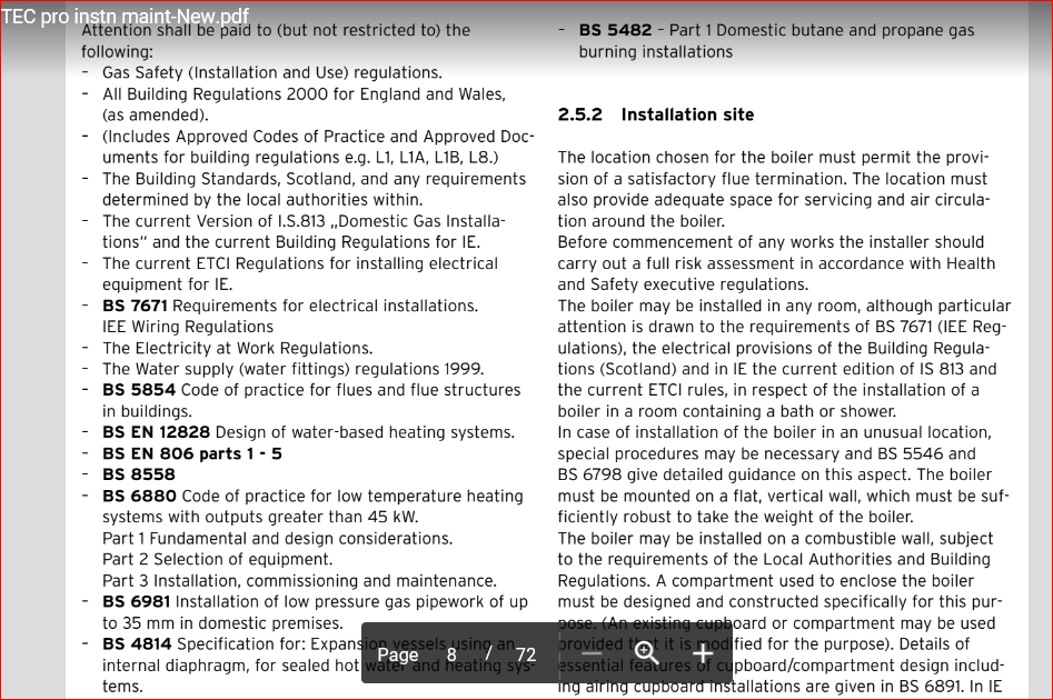

This is from a post 2012 vaillant ecotec...
Yes, and that identifies the various regulations which will, or may, apply to the installation of that boiler. That various regulations will apply is not in doubt.
But the problem is that none of the ones with which people here are familiar require that the supply to it be fused at 3A. Hence the question, why do Vaillant say it must be?

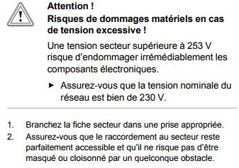

Indeed! The manuals appear area specific. In the UK the Vaillant instructions say:
Instead, the French version makes no mention of any fuse protection whatsoever, but is concerned instead about the boiler being plugged into an accessible, suitable outlet, and warns of the danger of fluctuating voltages o_O
Indeed! The manuals appear area specific. In the UK the Vaillant instructions say: .... Instead, the French version makes no mention of any fuse protection whatsoever, but is concerned instead about the boiler being plugged into an accessible, suitable outlet, and warns of the danger of fluctuating voltages o_O

Do we know whether the product sold in France is identical to the one sold in the UK?
Typically the manuals have parts lists/diagrams in the back - the key thing to look at is the main PCB/electronics module and see if they have the same part number. If they have the same part number, then for the purposes of this discussion they are identical.
Agreed.
Kind Regards, John
