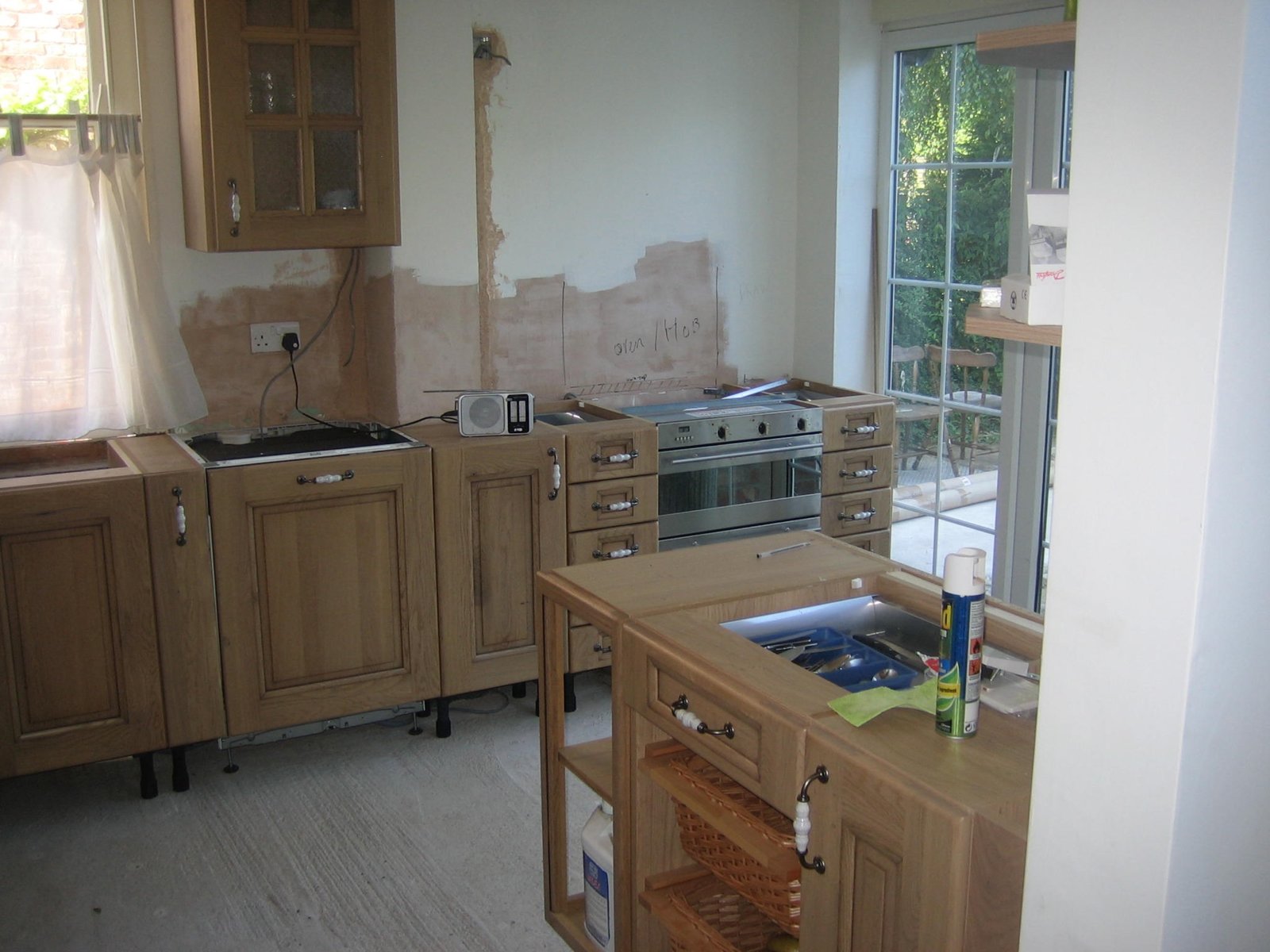

I fitted my kitchen in 2008 with a full rewire in there.
I did the kitchen and i used a sparky to do the wiring.
I remember we fitted a socket on the opposite side to all the other sockets and this had to run in conduit under a new concrete floor.
Anyway we have run our kettle from this socket in all this time. Recently the rubbish morrisons kettle has not been clicking off at boil point so it has been running a little over if we our out of the kitchen. Prob runs over for 10 seconds.
Anyway the socket no longer works and i have changed it with a new one and still nothing.
This plug is a spur off the main ring on the opposite wall. So runs from our socket with a radio on it and a small table top mixer.
Any ideas if this could work again because there is little chance of rewiring it?
Thinking of buying a socket test plug tomorrow.

The socket feeding the spur has the radio plugged in. The broken socket is where the fly spray can is sitting, but you can't see it.

Trevor ,there is something not quite right here . I know this was installed ,10 years ago ,could it be that some of the Info you are recalling from memory isn't totally accurate ? If the cable is totally in conduit ,why can't you pull thru a new cable ? Is any of it not in conduit ,for instance where it exits the floor and travels vertically ? Could there be a junction box ,floor level ,below socket with radio. The socket tester is very basic. You don't know if all three conductors are a problem or just line.
Well it is in conduit in the concrete and then it comes up the wall doesn't it. So getting this cable out is a big job.
No junction boxes used as new install.
