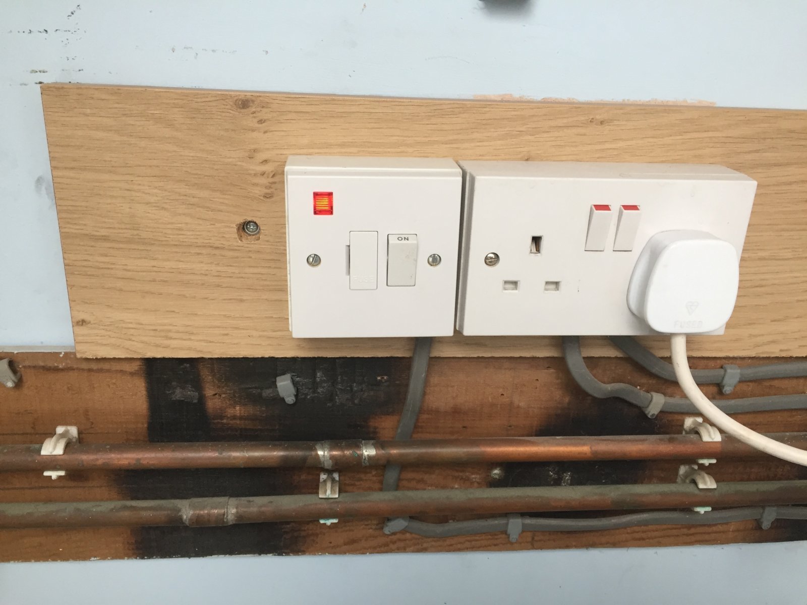

While I may have missed it, I have not discerned that anyone has suggested that the OP (trevorbayliss) should check the continuity of the conductors between the contacts of the "Socket Outlets" cornered and the "point of supply" to the "supply" Line and Neutral connections, wherever they are. (The Earth connection should also be checked, but that is another story.)
This connection check should be done with an Analog multimeter set to its "Resistance" range with the power supply concerned turned "OFF".
I agree with everyone who posted on the unlikelihood of a "failure" of the conductors in the cable concerned. The most likely possibility is a "Terminal Connection" failure, at either the "Supply" end or the "Load" end.
There could also be a break in the copper underneath the insulation where it's entered one of the boxes - the feed socket is more likely. Not common but I've seen it.
My vote is for a termination issue, or a failed contact in the socket and there actually is voltage at the socket
Sometimes the contacts wear so that you get poor contact with the plug pins.

It could be several things:
Poor connection inside the socket between the conductors and the terminals.
Worn-out socket.
Broken connection prior to the socket.

My socket is now working, but i don't understand what has happened here.
I have just fitted our new washer in the big cupboard this morning. In there i have a double socket on the kitchen ring. Next to that is a switched spur which was put there because we ran a single double socket from this spur next door into the conservatory. This has now been demolished and so the switched fuse has been switched off for ages.
Anyway someone on here said there maybe a connection in the ring and so i wondered if this switched spur was anything to do with my dodgy socket.
So i switched it back on and then went to plug my radio into this socket and hey presto it works. If i switch off this spur the socket goes dead.
So i have my socket working again, but i am scratching to understand what i have done here with the sparky to wire this ring up.
I enclose a photo.
It shows the socket next to it on the ring. Coming out of the spur is a cable which goes past the socket and then down into the concrete floor. I am wondering if this cable links into the dining room socket which is close to this cable on the other side of the wall. The kitchen and dining room has been wired on one ring as they are two open plan rooms really.
The feed from the spur to the conservatory has been removed.
