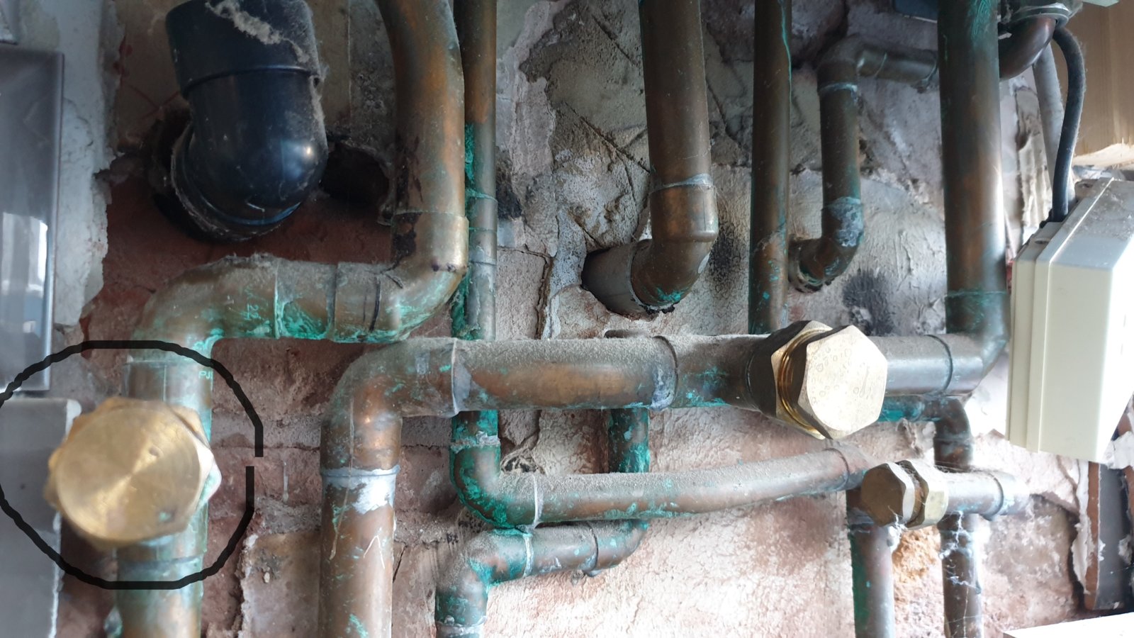

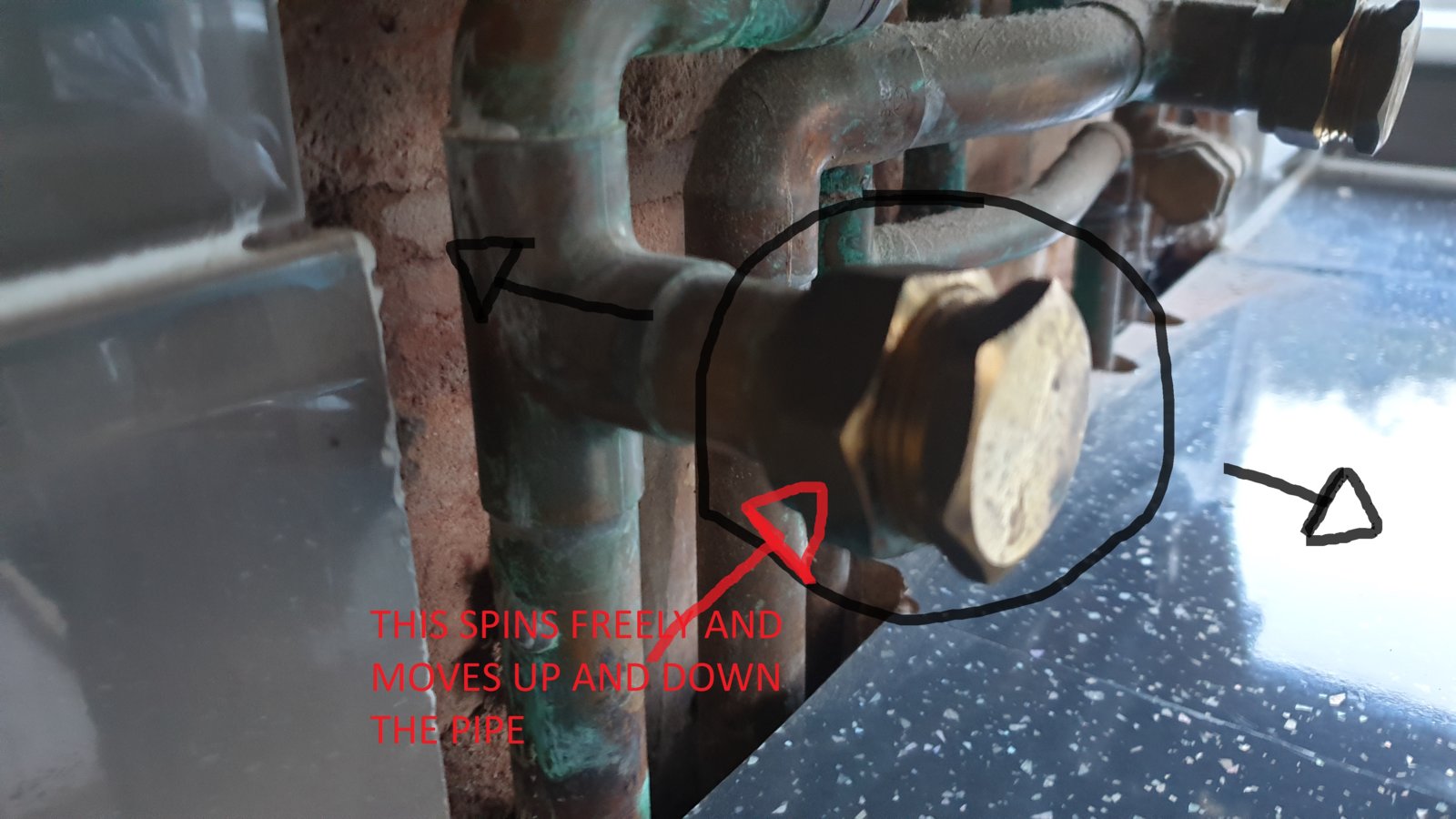

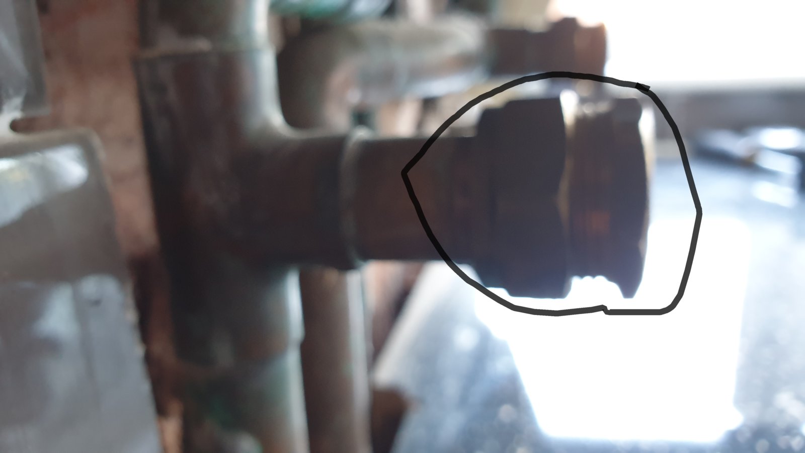

Hi,
Have used this forum a lot recently but this is my first post as i don't want something small to turn into a bog problem.
Hoping someone can help me identify and rectify what needs doing, i have just moved into a new house and the boiler seems fairly new its a combi boiler and worcester bosch,
i noticed a small leak from a pipe i have attached the images and circled the pipe.
this pipe gets hot when the hot water runs and the end cap moved up and down the pipe, i tried to tighten but it just spun freely i can push it in and it just pops back out im guessing its not supposed to do that.
how would i tighten it or stop the small leak, if i have to fit a new cap do i have to drain the system, i'm happy to cover it in flux and heat it with it in situ if that's a solution, I'm just concerned its going to be a major problem at some point.
Thanks in advance

Its a standard compression cap.
Hold the front cap still, with a spanner and use another spanner/wrench, to turn the backnut anticlockwise WHILST LOOKING AT IT FROM THE FRONT.
Think of it as holding a bottle screw cap still, whilst turning the bottle to tighten.
It might be that there's no olive :eek: or the olive has been pinched too far towards the end of the pipe.
It could go pear shaped on you so maybe drain down and remake the fitting.
I'd have a go at tapping it backwards and tightening, but then I'd be prepared for "eventualities" ;)

Thanks for that I will try this over the weekend, as you suspected I now have a nother question.
Can I isolate that pipe via the boiler green Star24i juniour mk iv or will I need to drain the whole system?
Thanks again.
Did this over the weekend and its all sorted thanks everyone for the help and advice
