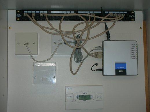

Home Network Patch Panel : How can they be mounted?
I used this for my home network, its fairly neat and doesn't take up much room
That's the 10" SOHO stuff I was talking about. The downside is that it's not as widely an adopted standard as 19", and as a result it seems to be more expensive with less parts available. Ideal if you haven't got much space, though.

Sorely lacking in quality hardware. Like gigabit switches.
Not really, at least if you don't mind your gigabit switch sitting on a shelf. And let's be honest, anyone with a small enough home network to be able to use one of these cabinets probably isn't the type who's likely to be fussy about everything being racked.
Personally, I can't stand non-rackmount kit in rack cabinets, but sometimes it's unavoidable. Just like wall wart transformers that you can't direct plug into an IEC320 PDU :evil:

Is there anything in particular I need to know to run a PoE switch/router? I am planning on installing a Cat6 network. Do regular devices (PCs/consoles etc) need to have a filter between them and the powered switch or can you select exactly which ports will be powered?
Thanks again.
PoE should be automatically negotiated between the switch and device.
