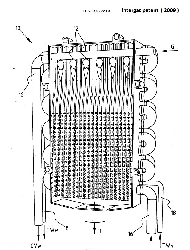

Compare that to the patent application diagram which shows U bends fitted to both circuits.
That is a large number of soldered joints to be made on an automated production line. No doubt the quality control is high and as a result the production yeald is high enough to make the design cost effective. Failure rate of installed boilers is very low and thus the joints appear to be reliable in service.
The complexity of the manufacturing the Intergas heat exchanger seems high compared to the tube in a tube construction of the Ferroli heat exchanger.
Bernard, I am not defaming the Intergas as its rep and solidity is beyond question. However, the CH side of the heat exchanger seems odd to me. The "U" tubes on the side of the heat exchanger seem odd. The water runs though the heat exchanger and out again and then back in via the "U" in the tube running up the heat exchanger as the water is heated. I wonder why, as to me it would make sense to have all the CH tube "inside" the heat exchanger. This must give off heat inside the casing and reduce efficiency.
Yet, the DHW tubing is 100% inside the heat exchanger.

It was found necessary to cast the aluminium block around the tubes under high pressure to ensure good contact between aluminium and the copper. To prevent the tubes being squashed by the pressure applied to the liquid aluminium during casting the tubes are filled with something ( sand iirc ) during the casting process. The ends of the section have to be open to allow the sand (?) to be removed. If the U bends were soldered before the aluminium was cast onto the tubes there is the risk that heat from the liquid aluminium could affect the soldered joints.
Yet, the DHW rubing is 100% inside the heat exchanger.
There are patents showng the DHW circuit assembled as per the CH circuit ( exposed and soldered U bends ) and other patents showing it in different formats. Possibly the smaller tube can resist the casting pressure and can therefore be bent to shape without the need for U bends to be soldered on. ( possibly a lower casting pressure is used )
I see. My logical thinking would be to insulate the "U" tubes on the side of the heat exchanger. Maybe too much cost for too little gain, or whatever reasons they have for not doing it.
