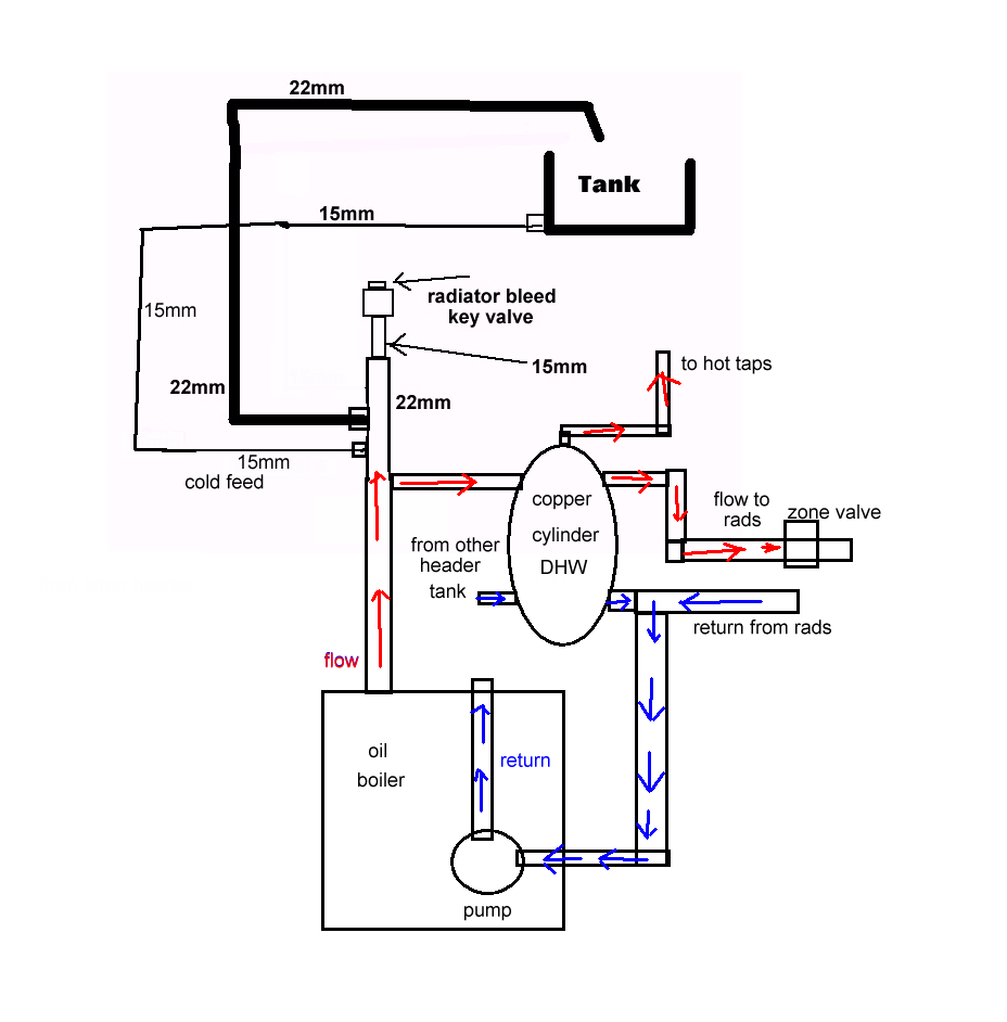

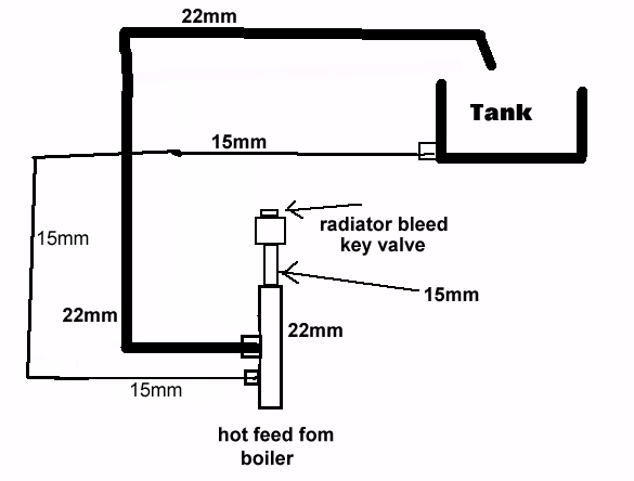

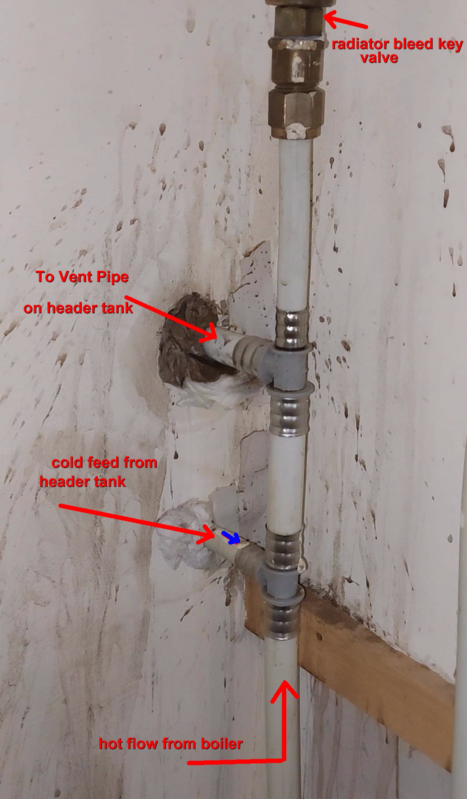

trying to get rid of an air lock in our boiler after emptying central heating system and looked in the airing cupboard at this setup . the alarming thing I found was going up into loft at the F&E tank expecting to see the cold feed being a 22mm ... but its only (equivalent) of 15mm - I say equivalent because our house we are in (Ireland) has not got the normal 15mm and 22mm copper piping for the plumbing it has this (expensive) German made metal pipe you can bend easily by hand (more easier than copper) and is covered with some white plastic outer material. The bores look even smaller than 15mm copper does , but its not microbore pipe.
but I think its a weird setup , 15mm (or equivalent) for the cold feed from the header tank in the loft but the expansion pipe 22mm (or equivalent).
here is a rough drawing:
any consequences whilst I have the water drained down to change it to this:

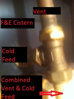

I can't figure your system out, but mine, from new, 53 years ago, with some rads over 40 years old has the circ pump in the boiler house, pumping into the (oil fired) boiler (return) the boiler flow then feeds all the rads and the HW cylinder coil, the 3/4" vent is carried on up from the T into the cylinder coil (top, inlet) and up and over the F&E cistern, the cold feed is teed into it as shown, the F&E cistern is spotless.
If you have a external circ pump (on the flow) then the vent must be taken off before the pump suction and can be plumbed up like mine. The more normal arrangement (with pump on the flow) is to have the Vent, then (no more than 150mm away) the cold feed, then the pump.

our central heating pump is on the return in our system in the outdoor boiler unit (so it must be pushing the water in the flow direction rather than pull from the flow.
the cold feed from the loft header tank seems to go on the flow pipe from the boiler rather than the return pipe.
here is a rough sketch. I think this is how I think ours work:
Assuming the 15mn pipe isnt blocked the setup is ok if not textbook.
You have MLCP pipe. Plastic with an aluminium barrier layer

has 15mm pipe got more chance of blocking up than 22mm feed from header tank do you think . and the 15mm feed there is OK going into the flow of the boiler in the airing cupboard? - when I have looked at setups in my other houses we have lived in I am pretty sure the feed from the header tank went on the return side of things not the flow side.
could i change the feed to this setup so the feed is on the return pipe to the boiler? - would that work? - if so could i keep the feed as 15mm or do i need a 3/4 (22mm) feed pipe there?

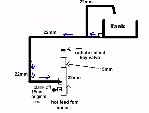

I would suggest just doing it like in your post #2, if possible tee in a piece of 22mm pipe (cold feed) from the cistern into the vent, doing it in the way directly above (post #9) stands the risk of getting pump over from the vent. its quite likely that there is a blockage, or partial blockage where the cold feed is presently teed in, so best to remove that altogether and just blank it.

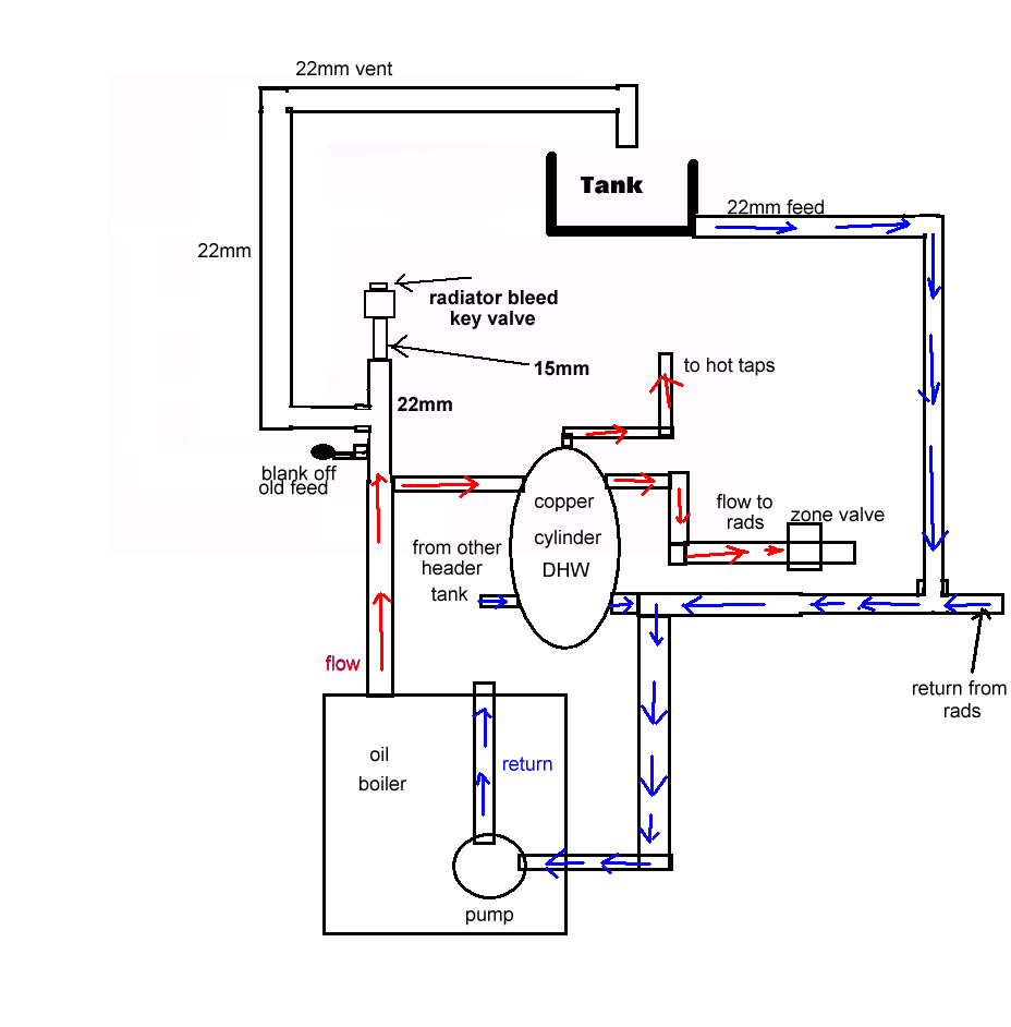

Thank you for your replies and help. so just to confirm no problem with having the F&E cold water feed from the header tank going into the flow pipe of the boiler then? , it does not have to go/make more sense to have the feed going into the return of the boiler then no?
No problem having a combined vent and cold feed with a boiler that has a high limit stat as well as the control stat, but not with a solid fuel boiler.
