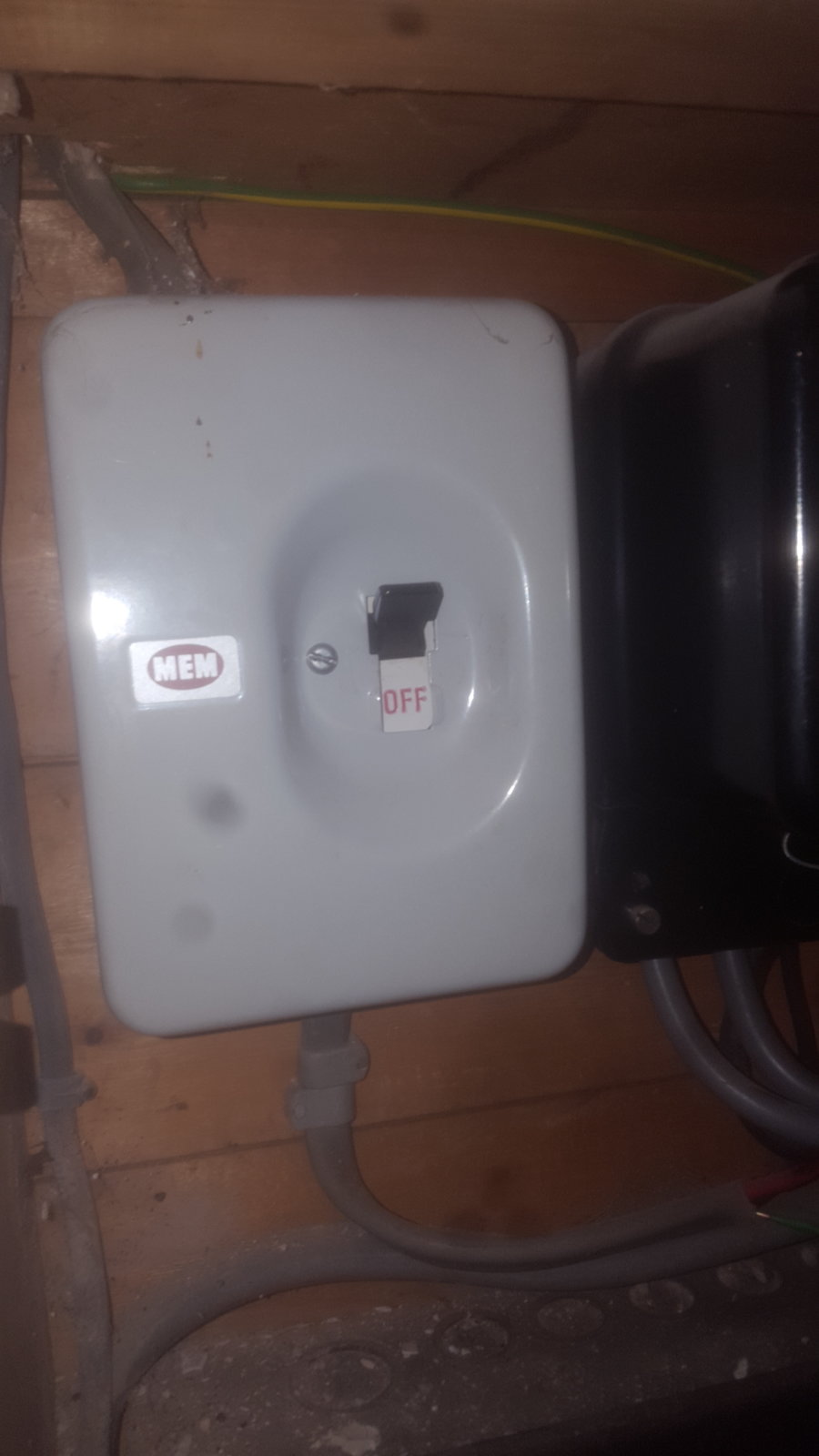

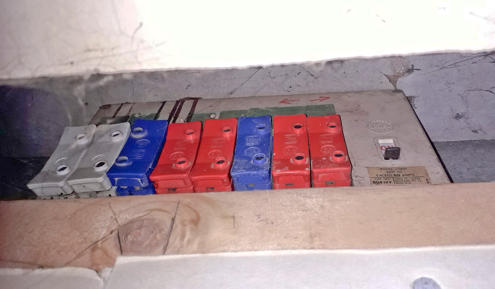

Is this fusebox illegal
It needs to be determined what kind of tubing you have.
Some conduits allow re-wiring with no disruption at all.
But some (narrow) conduit systems (with tight, clamp on bends) are virtually impossible to re-wire.
WARNING; removing any electrical covers could disturb the wiring and make it crumble, exposing bare metal wire, and could cause an electric shock.
Yeah wish i never wasted Money on this bath now....ill see what spark says tomorrow..maybe hold off my tiler and look for something else
A whirlpool bath is a relatively small load and there no reason why it cannot be spurred off a nearby socket via a RCD fused connection unit. No need to go near that fusebox at all.
No-one will connect to that crap.
Also the Earthing and bonding will almost certainly be inadequate.
Also RCD FCUs to BS 7288:2016 do not provide additional protection and therefore all reference to them has been deleted from the Wiring Regulations.
This is a good solution to get the bath going without disturbing the fuse box, but one has to wonder what the existing circuits are like, we don't even know what the earthing/bonding is like.
There was once an electric shower in the bathroom and the cable is still there...it is connected to the meter via this box

Had the same in my house, now replaced with a metal consumer unit all RCBO, but nothing illegal about it, but silly place for it, in my case between original ceiling and new false ceiling where garage made into a granny flat.
Another specimen from The House of Horror.
Maybe your electrician will be able to adapt this, but then again he may not want to touch it - see what he says.
