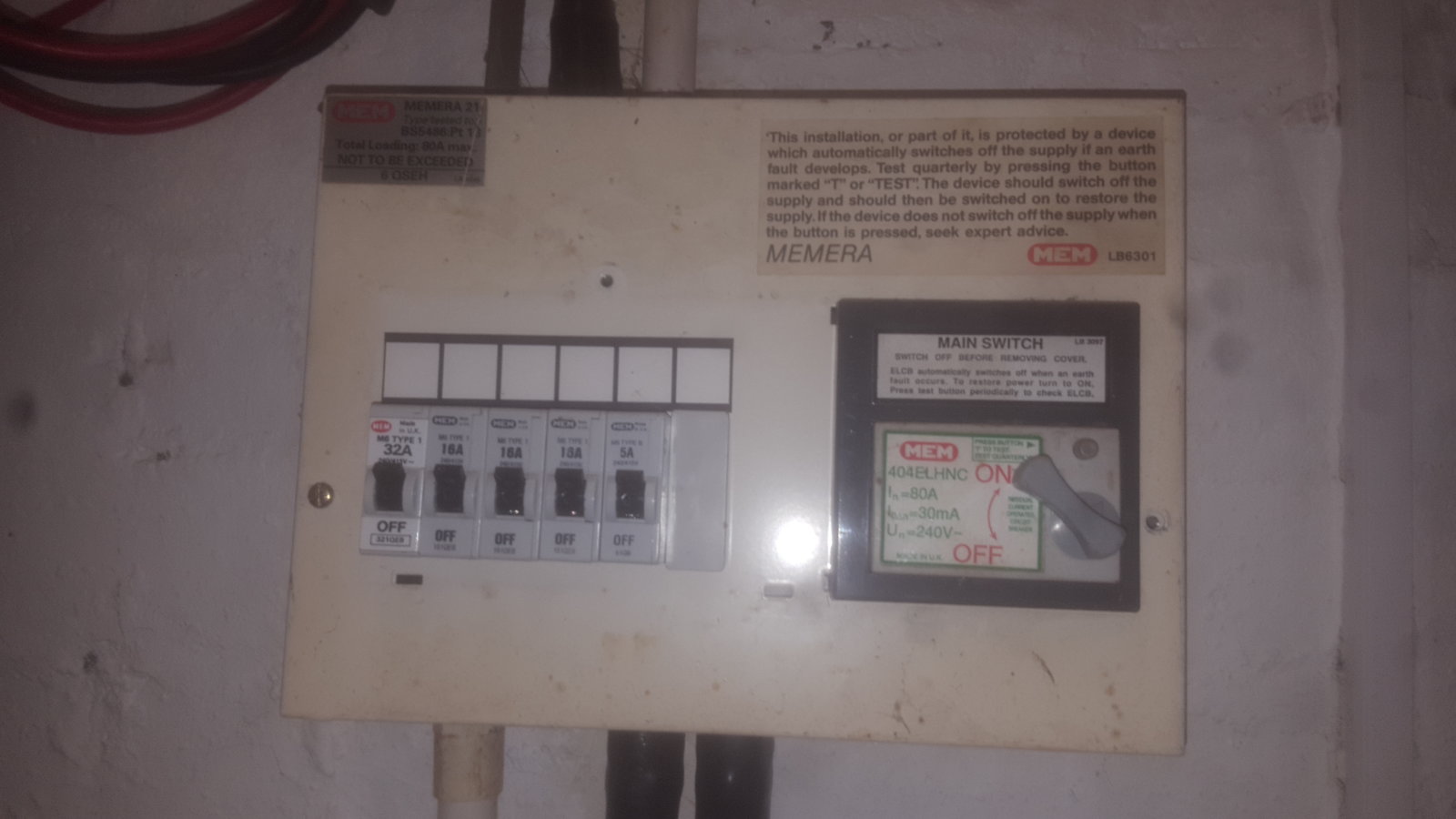

Is this fusebox illegal
So does this mean i cant run an rcd spur from another socket
I have this unit in my garage that has an rcd ...its used to power outdoor sockets....can this be used to run the bath....its connected to the same source as the house one

From what im reading and not being a qualified spark in any way......wiring the bath via an rcd spur from (for example) a plug socket will provide additional protection as in the spur will trip and kill power to the bath instantly ...whilst the wire in the fuse at the meter will also pop killing power to the said socket.......
Yes, but the things/situations that would cause an RCD to trip and a fuse to blow (or an MCB trip) are totally different.
The RCD will trip when there is a (often very small) leakage of current to earth - e.g. through a person experiencing an electric shock (or due to some 'leakage' fault in the equipment - e.g. due to water ingress). A fuse will blow (or MCB trip) when the current flowing in the circuit is excessive - such as when there is a 'short circuit' somewhere, or a major fault in the equipment).
