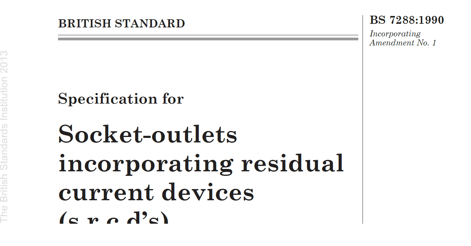

One of these things, for example
http://www.greenbrook.co.uk/bs7288-powerbreaker-rcds-10ma-rcd-twin-switched-socket-metal-bs7288-1663
used to be popular in garages or where you might plug in garden tools "for equipment to be used outdoors" and the house circuit did not have RCD protection.
Full Description
BS 7288:2016 applies to residual current-operated devices (RCD) incorporated in, or specifically intended for use with, single pole and neutral and single pole and switched neutral and double pole socket-outlets, with provision of earthing of the socket-outlet for household and similar uses (SRCD: socket-outlet residual current devices). SRCDs, according to this standard, are intended to be used in single phase systems such as phase to neutral. SRCDs are only intended to provide supplementary protection downstream of the SRCD. SRCDs are intended for use in circuits where the fault protection and additional protection are already assured upstream of the SRCD."
Well, I didn't look at the other standards, but 7288 is specifically for rcd protected socket outlets, and I have assumed the others are basic rcds which can protect a whole circuit or more than one circuit. If that assumption is correct, there is a clear difference. You certainly couldn't fit your 7288 device in a consumer unit.
Yes, maybe it's almost semantic - a BS 7288 device can obviously only provide 'additional protection' to things plugged into them, not to any of the actual circuit.
Do you know what Standard is applicable to RCD FCUs, since they obviously could be providing 'additional protection' to fixed wiring in some situations?
Kind Regards, John

Official spec for RCD FCU was BS4293
531.3.6 exists regardless of the hearsay or contents of BS 7288. If you read the iet forum link above there is a suggestion that 'additional protection' in this sense (2nd part of 531.3.6) means for buried cables, also ppl saying it's badly written or ill informed
