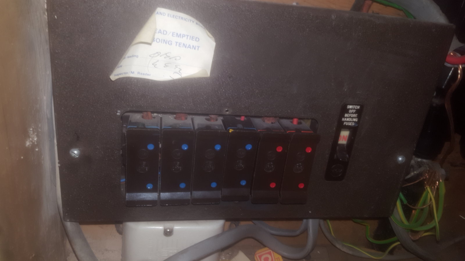

Is this fusebox illegal
This is a better photo of the cu.....can this be upgraded without rewiring the whole house...we have never had a single light flicker or blow and every bulb in the house is led
As has been said above, the real problem is the cabling not the CU - it looks like VIR cable (google it) and will crumble and short out if you look at it the wrong way. I wouldn't want it in my house!
The thing is ive changed every socket in the house and ran spurs with new cable and never once come accross a brittle wire....the original wire is black and red with material covering...most of the time ive needed to cut quite hard to get through the insulate
No.
Replacing a consumer unit requires that all of the circuit connected to it be inspected and tested, and any problems fixed before the new consumer unit is installed.
60+ year old cabling can't be fixed.
Guy came today ...very professional and certainly knows his stuff...its looking likely that it can be run from the separate fusebox in the garage so no need to tamper with the old one in the house other than to remove the old grey box that used to run the shower......maybe next year i will get him back to replace the house one and rewire where necessary.....i certainly feel happier getting a professional in instead of following the muppets that attemp these things themselves without qualifications..... thanks everyone
Think im going to get him to cone back next year and change the meter or if possible relocate it and rewire the whole place.....we are needing to redecorate anyway.....but can rewiring be done without damaging ceilings ?...we have upstairs...would rewiring mean lifting the floors .....we do have metal conduits
