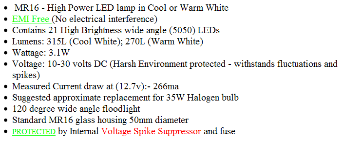

I look at this advert:-
The point is very near 100 lumen per watt, and it would seem that's about right for a LED lamp. But the down side is £14 each and DC. Clearly some sort of switch mode regulation be it called switch mode or pulse width modulated it's really the same thing. But when I looked at my MR16 lamps looking at 60 to 70 lumen per watt clearly using some cheap and nasty way to regulate the current.
As to looking at the lamp in my living room 10 lamps 9 are 3W and one is 1.4W I have asked many a visitor to identify the 1.4W and in the main they fail. I also swapped a tube 5100 lumen to 2400 lumen again could not notice it being any dimmer. However have noticed I need to ware my glasses more to read things. I think our brain associates colour with brightness and we think if reddish it's dim and blueish it's bright and since dimming a LED does not change colour we don't see it as being dimmer.
