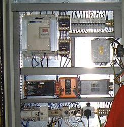

Since in a distribution unit, the devices do not need to be on the type list, in fact in a non-domestic there is nothing to stop me making my own units, which I have done many times, with PLC's, contactors, and overloads all in the same box, panel.jpg the question only arises with domestic, and I fail to see how something allowed in commercial becomes potentially dangerous when used in a domestic environment. There was a plastic cover over much seen, to allow the door to be opened to program the PLC, however I got a rap on hand from HSE for leaving the key in a door, he said the key could be used with any other door, so must be removed.
