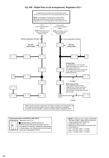

However, now i want to add one to the back garden. I was wondering would it be possible to just wire it directly into the plug socket rather than to a 3 pin, taking up a socket? After watching a few youtube videos they say you simply add the ends of the wire to the terminals... Is this true?
The plug it's working into isn't on a spur. Things we will plugging into the outside plug will be a small water feature, a strimmer or fairy lights etc.
ty for any help you can give :)
It depends if a ring final or radial, or a spur off a ring final or radial, it is not simply just connect up.
The plug has a fuse in it, and we are only allowed a single or double socket on a spur, a double socket is rated 20 amps, not 26 amps, and the whole system is designed to limit the power to a safe level, there is also what happens if water does get in.

ty! it's not a spur but not sure what a ring final or radial is sadly so I can't be sure about that one. I'll just do it through a plug then lol ty.

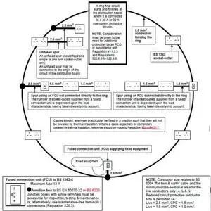

The best way to find out if the socket is suitable to be used for your outside socket is to check the size of the MCB and the cables feeding the socket, as Pete said.
A ring final circuit is fed via a 30 or 32A device and normally has two cables at each point on the circuit, sometimes three if an unfused spur has been taken from that point.
See the diagram that Eric posted.
A radial final circuit is fed via either a 20A device, sometimes 16A, (in 2.5mm² usually solid core cable) or a 30 or 32A device (in 4mm² stranded cable) and usually has two cables at each point, sometimes three, and one at the end of the circuit, as (unlike the ring final circuit) there is no cable returning to the supply.
The cables I have described here are modern metric sizes. It is often said the quickest way to distinguish between cable sizes on socket circuits is that if it is solid core, it is 2.5mm² and if it is stranded, it is 4mm².

@securespark has given a good answer, in essence a spur and a radial are the same, but we have English to contend with, if something is final as with ring final, you can't have a final final in English same as saying the very end, it is simply the end.
So a fused spur is really a new circuit, and a radial from the ring final, but English will not allow us to have a new circuit from a final circuit so we invented new words and phrases to label them.
So we have:-
Ring final - where sockets are supplied by two cables arranged in a loop. In the main using 2.5 mm² cable and a 32 amp MCB/RCBO. There may be old installations using 30A fuses, but to extend such a ring final one would need RCD protection so not straight forward. Maxium lenght is around 106 meters.
Radial final - Can be 1.5 mm², 2.5 mm² or 4 mm² with a 16 amp, 20 amp or 32 amp MCB/RCBO with 32 amp one needs to be careful to continue to use 4 mm² (or 6 mm²) with a 20 amp radial using 2.5 mm² maxium lenght is around 32 meters, which is why not popular.
A spur - uses a smaller total cross sectional area so typically 1.5 mm² or 2.5 mm² when comming from a ring final a single 2.5 mm² means half the cross sectional area as only one cable used, the spur is sub divided into a fused spur (really a radial) and an unfused spur, with the latter you are only allowed a single device, this means if people have followed the rules, you can identify an unfused spur as only one cable goes to it. However, this relies on those before you following the rules, with a fused spur, you can have as many sockets as you want.

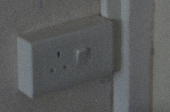

What I have done when I have found a doner socket supplied with an unfused spur, is to add a fuse. IMGP7387c.jpg Using the LAP grid switch system, a socket, fuse, and switch will fit in a double socket box, shown here where I wanted to extend an unfused spur circuit.

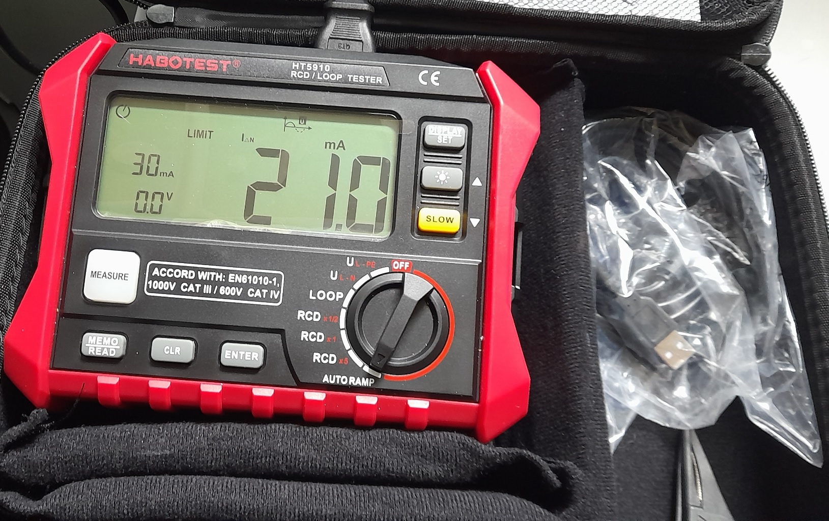

For the electrician it is easy, we use our expensive meter, RCD tester ramp.jpg and write down the readings, shown here testing the RCD, so we can take a loop impedance reading before starting, (this also tells us how long the cable is so not exceeding 106 meters) and note reading, test the continuity while fitting the socket, at the socket, and then loop reading again when complete, and this will highlight any errors, like a wire popping out of the terminal, the DIY guy does not have this option, so you have to be very careful to ensure all wires are tight.
But even if these 1780996749526.png testers don't show if the loop impedance is low enough, as will pass at 1.9 Ω and the pass mark for a ring final is 1.38 Ω, they will pick up most major faults.
