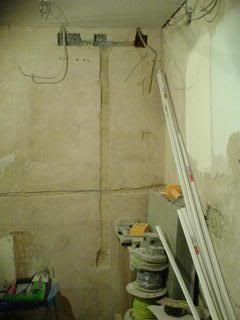

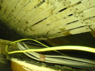

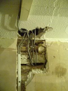

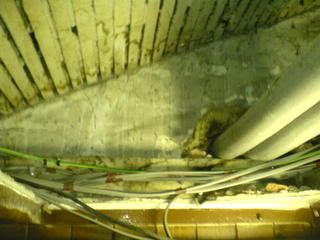

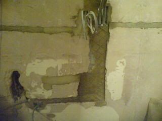

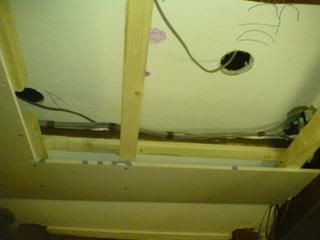

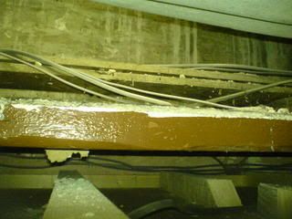

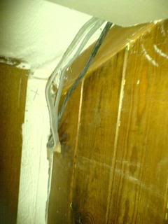

Cables above the ceiling
5 downlights cables
3 downlights cables

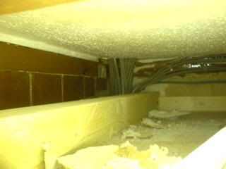

Cables above the new ceiling

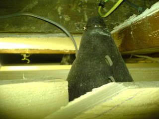

Fire hood above one of the downlights (all of the downlights have one)

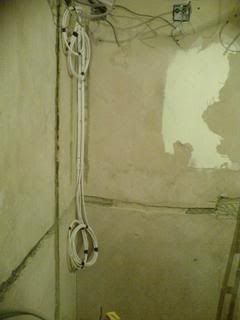

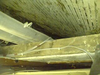

Cable for Back Floodlight & Utility Room light
Cables for Utility Room Ring & Smoke alarm

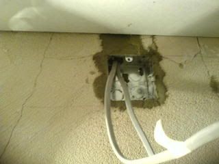

Cables to the Fridge socket
Fridge double socket

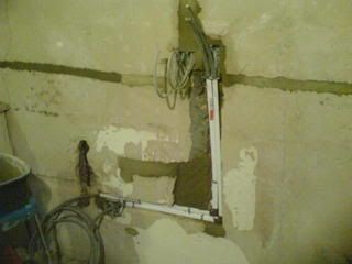

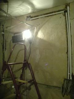

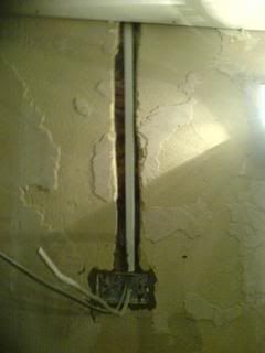

Cooker hood cables
Cooker Hood socket
Cooker cables
Cooker Cables

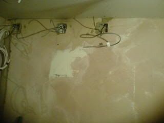

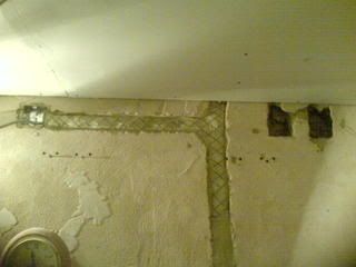

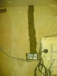

the 1st under cupboard lights socket
Holes for DSO, 2 FCUs & a 15A Round pin socket (below worktop, fed from 1 of the FCUs)
TV & under cupboard lights cables
The 2nd, 3rd & 4th Under cupboard lights sockets

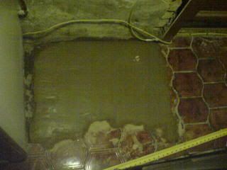

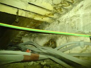

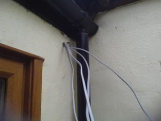

Hole in floor on sink side, filled, & new earth cable (It is the one coming out of the piece of conduit, by the back door. The other earth cable is the old one)

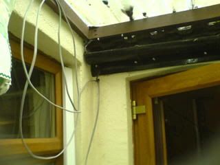

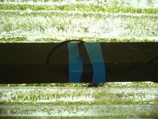

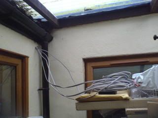

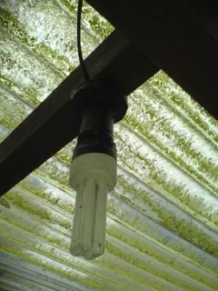

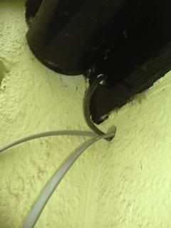

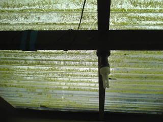

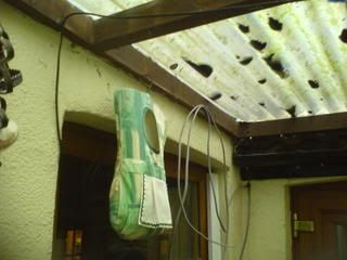

Here are some pictures of the temp. courtyard (Utility Room) light
The light
The switch
The supply cable
The light just plugs into a socket in the dining room

Last time I saw an old ceiling above a new suspended ceiling a lot of it was laying on top of the suspended ceiling having been weaked by condensation and damp.

Did you change the yellow crimps and have you had your BCO inspection at first fix (given most of your work is now inaccessible for inspection).
The feed to the cooker hood, the horizontal run will require the socket to be visible otherwise there is no safe zone between the "T" junction and the socket.
