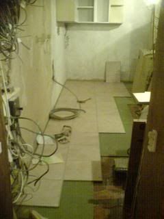

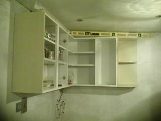

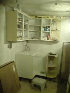

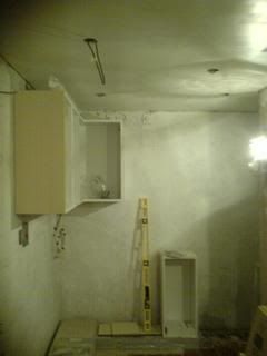

The New Kitchen units being fitted
Some of the new wall units up in the corner
All of the new wall units up in the corner
Some of the new kitchen floor, layed down
Corner floor unit in place
I'm expecting this to be a very nice kitchen.
