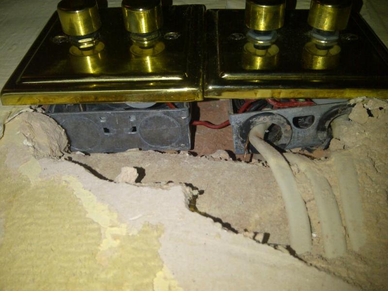

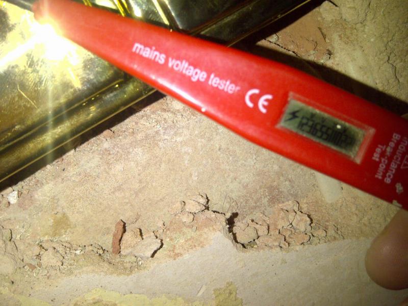

I have concerns about how safely wired one of the light switches is, got an admittedly cheap mains voltage tester pen that suggests potential on the faceplate and the wiring looks a mess - this should have been checked right?

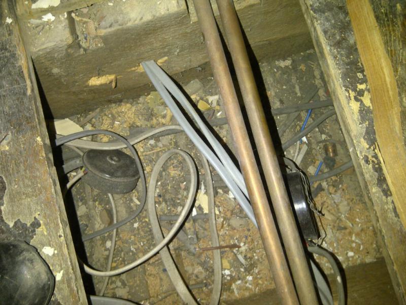

Old junction boxes, one held together with wire remain under the floorboards on the landing, at least one of them is still carrying power - should these have been replaced, and I read somewhere that regulations now do not allow for any screwed connections to be hidden, is that right?
Is this a metal faced switch? And what sort of cheap voltage tester pen?
Junction boxes held together by wire unacceptable and must be replaced by ones that require use of a tool to access live parts.
Screwed connections under floors are acceptable if there's an access trap cut in the floor but most people would replace with maintenance-free JBs in this location now due to access issues with laminate etc.

Chief safety worries are with the dodgy looking switch and the dodgy looking junction box. (also shouldn't the JBs be screwed to the joist?)
I'll try to upload pictures of both, as well as the Mains Voltage Tester I've used.

Switches look rough but hopefully he will remove and replaster/make good.
The unsheathed red wire between the switch boxes MUST BE sheathed or in conduit. Live and neutral MUST BE run as a pair through the same cable and box holes (eddy current in metal boxes).
Are those switch boxes actually big enough for the dimmer switches?
The junction boxes should be screwed to joists and the cables clipped each side. The cable sheath MUST BE continued inside the junction box.
Overall the standard of work looks rough but not actually unsafe.
