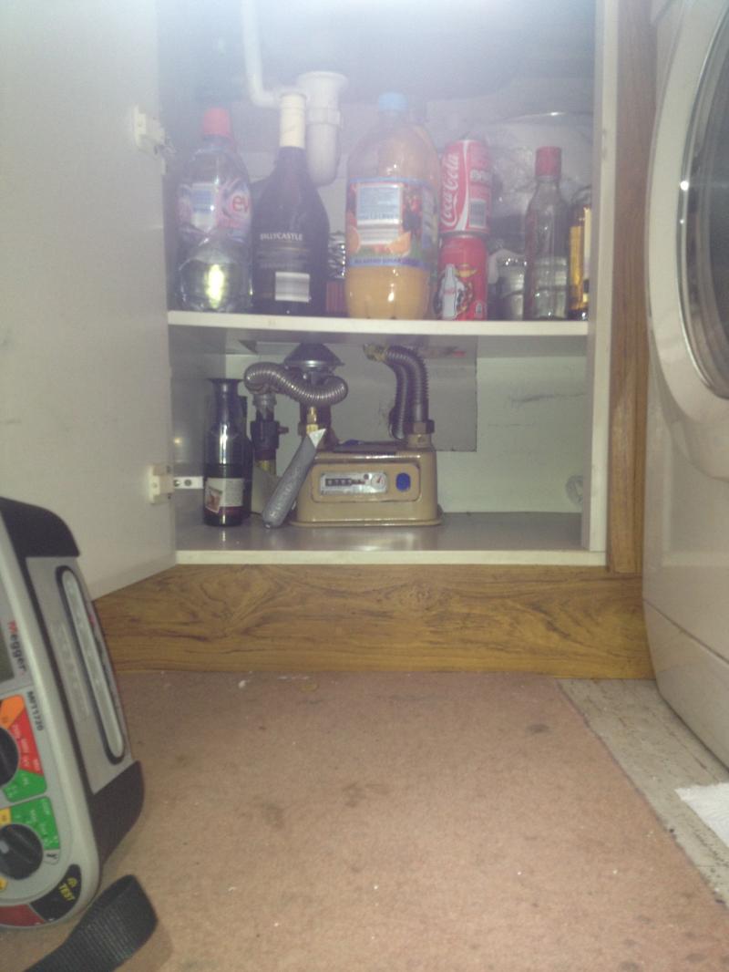

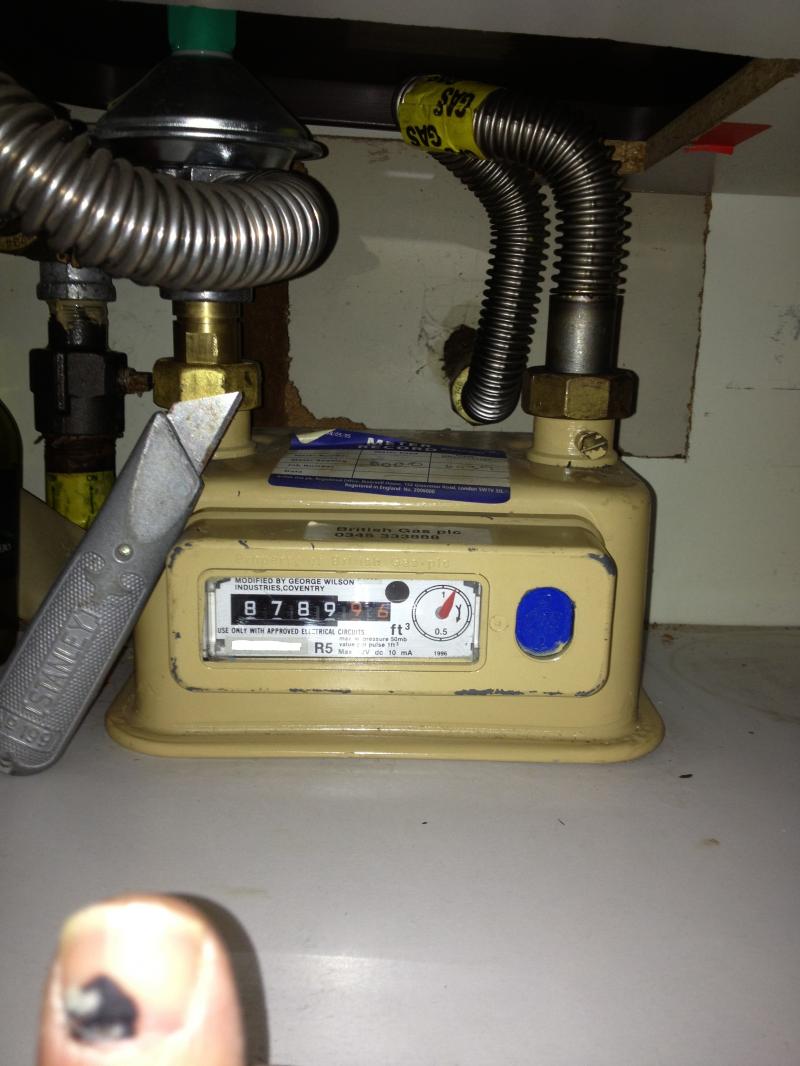

    Would you put M.E.B. clamp on the little bit of consumer pipe work before it enters plaster ? if not then where?
    the meter is buit into kitchen unit
    right bast to get at

    Don't see why not, what an awkward place to have a meter!
    You also need to avoid hitting your finger with a hammer :LOL:
    Nice megger too ;)

    Doesn't necessity dictate the answer? - as you imply, if not there, then there would appear to be no alternatives!

    I didn't have any other option. I was wondering if anyone else had any better ideas? As the clamp certainly wont be in an accessible place.
    The mft is actually there to stop door swinging shut

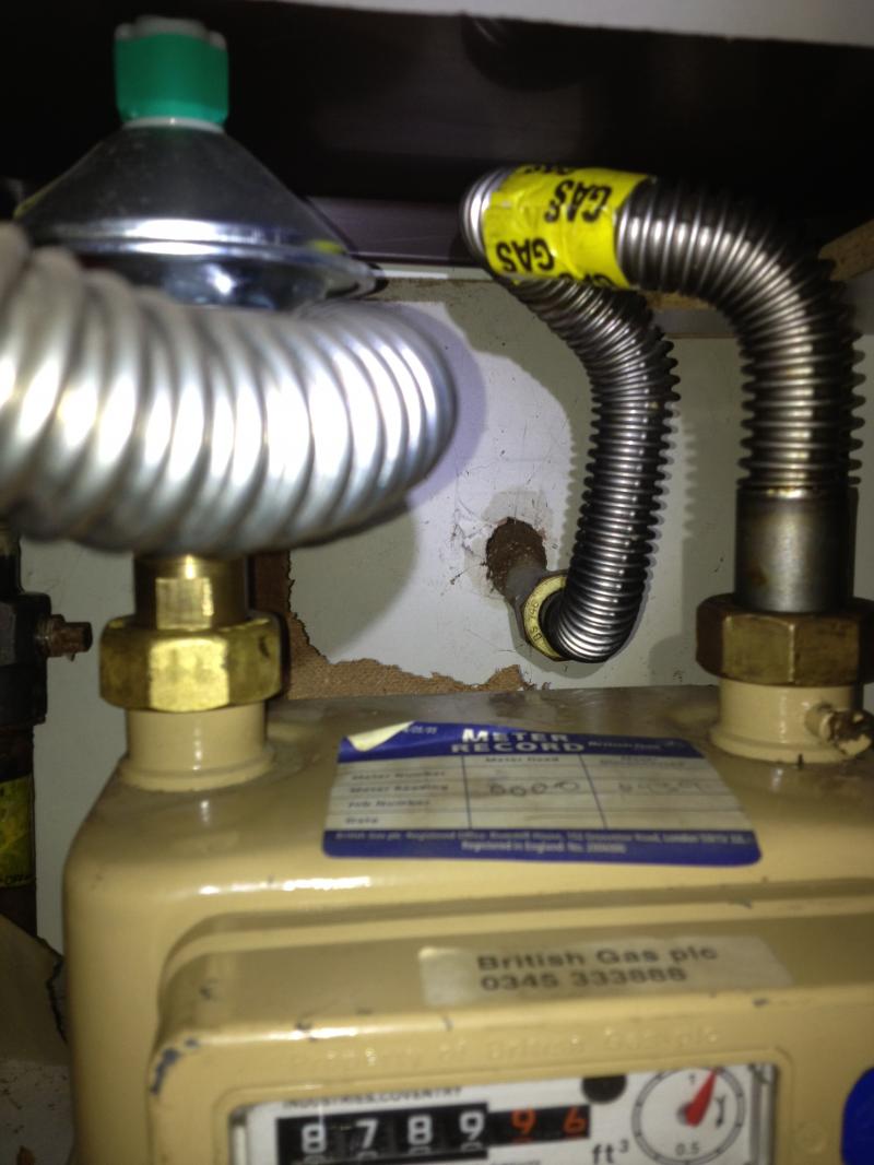

    I'm not sure it's 'inaccessible' is a BS7671 sense - i.e. a non-MF JB there would probably be technically compliant (if it were not for the proximity to the gas pipe!). In any event, is there actually any explicit requirement for MEB/MPB terminations to be 'accessible'. It would make some sense, but I'm not at all sure that there is any such explicit requirement.

    Well if someone ever did an EICR they might not be so reasonable.
    Condition and accessibility of main protective bonding conductor connections (543.3.2; 544.1.2)
    And with it being a new peice of bonding i would like to have removed the ambiguity.

    Also the requirement is clamp is in a visible position: 514.13.1

    Akward to get to is fine. Inaccesible isn't.
    I see no issue with putting it on that bit of pipe. It can be seen, and you can get a test probe on to it for inspection and testing.

    The locations is going to be documented on the cert anyway, if your confident that the clamp is visible and accessible, no probs! I have seen much worse.

    Yes, but you had no other option - and, as has been said, it is accessible enough to satisfy I&T requirements.
    Quite. What would you say (given that it appears to be compliant) - just that it's 'awkward'? Anyway, pragmatically, what would it achieve? - no-one is going to move the gas meter as a consequence, regardless of what you write!
