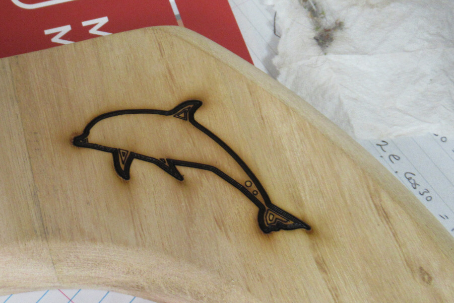

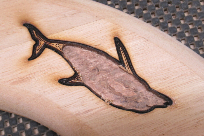

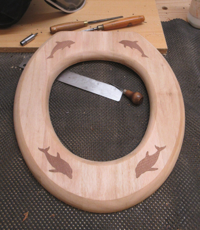

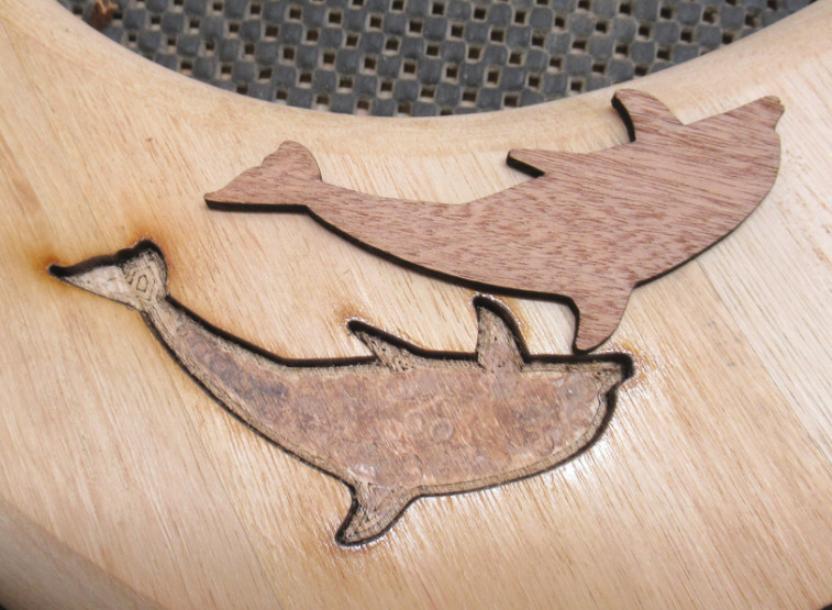

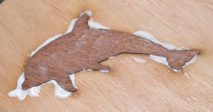

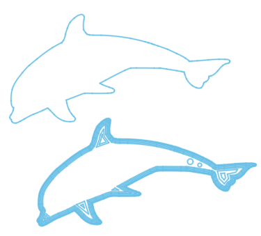

Back to the Bog seat and how i cheat with that intricate inlay stuff
@fillyboy @Highway Man
first find an image - plenty free stuff on internet if its non commercial
convert these into DXFs
make one to cut out the body, then a one with multiple lines to cut out the recess
then burn them out, I have used teak hear that I have cut to 3mm thick
the recess is cut out marginally smaller to get a tight fit
then use a router to get as close to the edge as I dare and just under 3mm deep
then finish off with a sharp chisel - the laser has created a very definite edge to chisel up to
then whack it in and hope for the best,
finish off with a scraper
As simple as that

Absolutely amazing is all I can say. It looks stunning and I can see a cottage industry set up making these. Hand made bog seats for celebrity's.Back to the Bog seat and how i cheat with that intricate inlay stuff

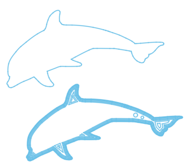

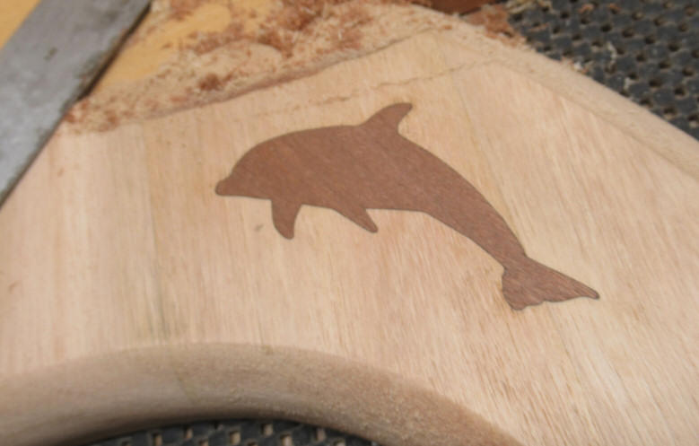

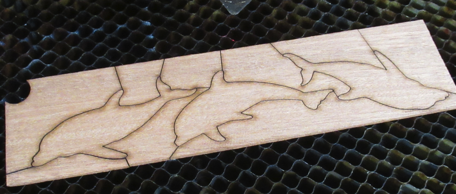

As simple as that
