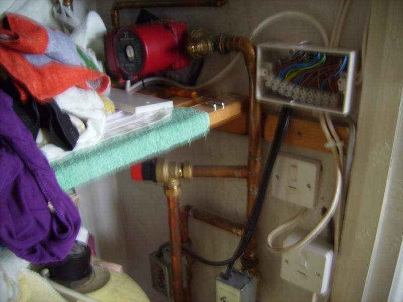

    Getting desperate and need advice please!!!!!!!!
    I've got a problem with the above boiler installed 2 years ago under warmfront scheme by Carillion (lots of problems with installation but working ok after a few weeks and corrective visits )- had 2 annual services since with no problems.
    at the end of the 2 year guarantee got British Gas cover for future problems and their engineer came 12 days after guarantee 'ran out' to inspect system - he reported 'pump overrun not working' (he checked Worcesters installation guide online and stated this should have been connected at installation, but nowhere said it was connected or not (installation failure or breakdown?) - when the boiler stops there is the sound of water (running back the Br Gas man said) for a few seconds and it has always done this - even through the 2 years inspections.
    I dont understand the workings of this boiler so have to ask for advice - how do i find out if the pump overrun was connected at installation (Carillion say Br Gas eng report did not say enough, only that it was not working - they want to know if 'never' working or 'broken'- unfortunately if it was 'broken' Carillion say it is now out of warranty (12 days from the 2 year warranty ending and Br Gas arriving to inspect.
    I've asked Br Gas if this problem affects my cover for future problems and have been assured via email it won't but would like to know how to find out if the problem was with installation -
    please can somebody advise me what's what - so i can understand the pump overrun - do i need to get another engineer in to check it out and how easy is it to find out what gone wrong.
    hope someone out there has time to read this and what i've put down makes sense to someone as Carillion are not interested unless Br Gas report says why pump overrun is not working.
    cheers
    ian

    You may be able to find out if the pump is connected to the boiler without calling BG or an engineer. You just need to follow simple instructions. ;)
    Can you see the pump? Something like this:
    Does the lead go direct to the boiler or into a junction box?
    If it goes direct to the boiler, it has been wired correctly. The overrun fault is in the boiler.
    If the lead goes to a junction box, we need to find out what happens inside the box. So TURN THE POWER OFF and take the cover off the junction box.
    If you have a camera, take a close up photo of the wiring inside the box (make sure you also show a little of the cables going into the box) and post it here. We will be able to work out how the pump has been connected.
  7. satinseat
    satinseat
    Joined:
    1 Aug 2012
    Messages:
    12
    Thanks Received:
    Location:
    Cambridgeshire
    Country:
    took a photo of the overall layout of electrics in the airing cupboard (boiler is downstairs in the kitchen) and a close up of the jumction box.
    lots of wires going into this box - from pump, valves, timer, tank, etc -so many l got lost in my own airing cupboard.
    gosh someone is clever if this all makes sense!!!!!
    thanks for your time
    ian[/img]

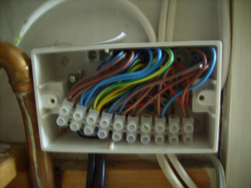

  8. craig51
    craig51
    Joined:
    5 Aug 2006
    Messages:
    539
    Thanks Received:
    34
    Country:
    ON the far right hand side, in the junction box, there are 2 orange and an brown. Is there another wire in there??
  9. satinseat
    satinseat
    Joined:
    1 Aug 2012
    Messages:
    12
    Thanks Received:
    Location:
    Cambridgeshire
    Country:
    going in to the top of the far right side are: brown and grey (thick) and 2 reds (thinner)

  11. D_Hailsham
    D_Hailsham
    Joined:
    18 Oct 2007
    Messages:
    10,587
    Thanks Received:
    1,344
    Location:
    Kent
    Country:
    Terminal 1 on the left; 10 on the right.
    Do the two reds in 10 come from the black cables to the motorized valve?
    Does the brown wire in 10 come from the white pump cable?
    If so the pump has been wired incorrectly.
    Is there anything in the terminal 9?
    If so, is the wire part of the same cable as the grey one in terminal 10?

  13. craig51
    craig51
    Joined:
    5 Aug 2006
    Messages:
    539
    Thanks Received:
    34
    Country:
    If you can (with power off) trace thre wire from pump. I bet as it enters the junction box, on of the wires will go into 10.
    Thids means the pump will only be active if the motorised valve is 'active'. This is incorrect as power will be cut when valve closes, not when boiler is cool enough.
  14. satinseat
    satinseat
    Joined:
    1 Aug 2012
    Messages:
    12
    Thanks Received:
    Location:
    Cambridgeshire
    Country:
    sorry it took a while but i feel a degree in electrics comin on - we had a look and the answers are-
    2 reds in ten come from each of the black motorised valve cables
    brown in 10 does come from pump white cable
    terminal 9 is empty
    if this convinces you that it has been wired incorrectly (any written response from you would be good enough for me but bet Carillion will want more) i will pay for an engineer to come and report to them on the basis i will claim the cost of that report against Carillion - Do you agree also that this installation failure has caused damage over the 2 years since install?
    concerned about the future cause repairs are expensive and maintenance contracts always worry me when it comes to claiming.
    really appreciate your help - you would not believe the stress this has caused and how 'carillion' and the 'warmfront team' seem to be the same .
    finally the bonus was the sight of the wife bending in the airing cupboard checking the wiring (when i remembered to switch it off)
    thanks again and hope you can confirm installation wrong - from what you said last time even i think i can get it.
    best regards
    ian
  15. D_Hailsham
    D_Hailsham
    Joined:
    18 Oct 2007
    Messages:
    10,587
    Thanks Received:
    1,344
    Location:
    Kent
    Country:
    Correct
    Wrong
    I would suspect that this has happened because the wrong cable has been installed between the junction box and the boiler.
    That's useful. Provided the correct cable can be run to the boiler, the pump brown lead can be connected to 9 and to the boiler via one of the cores in the new cable.
    That's a good idea. Get the engineer to write his report (pics are also useful) and quote for correcting the error. Send the report and quote to Carillion. Ask them to pay for the work.
    Hard to say - possibly. You would need someone from the boiler manufacturer's to strip the boiler and produce a report.
