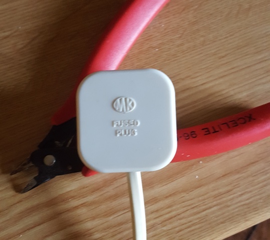

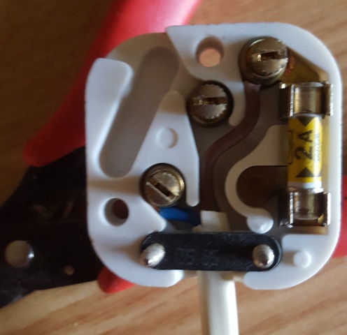

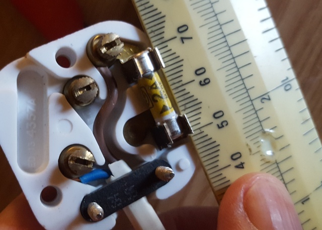

2A plug 20230924_173324.jpg20230924_173416.jpg from a table lamp in the house20230924_174107.jpg

However BS546 also has standards and that didn't include fuses in plugs. There isn't really a problem adding a fuse if such is deemed to be required however the physical dimensions of BS546 plugs is in the standard (Just as true for BS1363) and the size constraints simply does not allow for a BS1363 fuse to fit in a BS546 2A plug.
The plug pictured by Sureitsoff? does not comply with BS546 simply because it exceeds the maximum dimensions in the standard. Added to that it has a BS EN 60127/2 fuse (20x5mm but the standard also covers 1.25x0.25" and possibly more sizes) The maximum rating in the standard is 35A (which would theoretically not blow if used on a UK ring final using 32A MCB) and of course there's a good chance an oversized fuse may be fitted in a BS546 plug.

Think those fuses might be to BS646 and also used in 13A -> Shaver adapters
I know of a school theatre installation, where 15A plugs were used to suit the dimmer packs, but they were fused and 5A fuses fitted to allow the use of 0.75mm flex and those fuses were to BS646. I've not seen fused 15A plugs anywhere else
2A fused plugs were made by MK. Not sure if they are still available new. The fuse was the same size as in a clock connector and were available up to 5 amp rating.
Also 20 x 5mm glass fuses would fit.
Yes I knew they were/are? available and I always believed them to be standard 20x5mm fuses, which as I stated before are available to 35A.

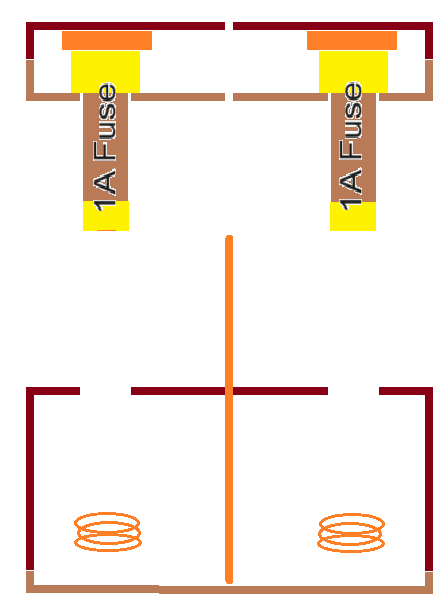

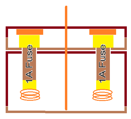

The clock points I used were round and would fit on a besa box, the fuse which I haven't found on google was about the same length, if anything marginally shorter with asymmetric end caps possibly ¼" and 3/16" with no chance of inserting it the wrong way round and only available in 1A.
The other style were older brown bakelite about 1½" diameter and 2 parts with a brass stud through the middle and a round knurled nut to hold the plug in place making it 1½" high, The pins of the plug were the same fuses with the larger end cap trapped between a brass contact and the Bakelite body preventing it coming out of the plug. The socket was a pair of brass springs which the fuses simply pushed against.
They were available with 2 fused pins or one fuse with the second pin being square.
Broadly like this:
There was also a 'break jack' contact option for impulse clock systems, that may possibly have been the version with the square pin.

BS646 are ¾" long ~19mm and noticeably shorter and just a little fatter than 5mm.
The 5A & 15A fused plugs are more likely to be 20x5mm or 1¼"x¼" to BS EN 60127/2 / BS4265
