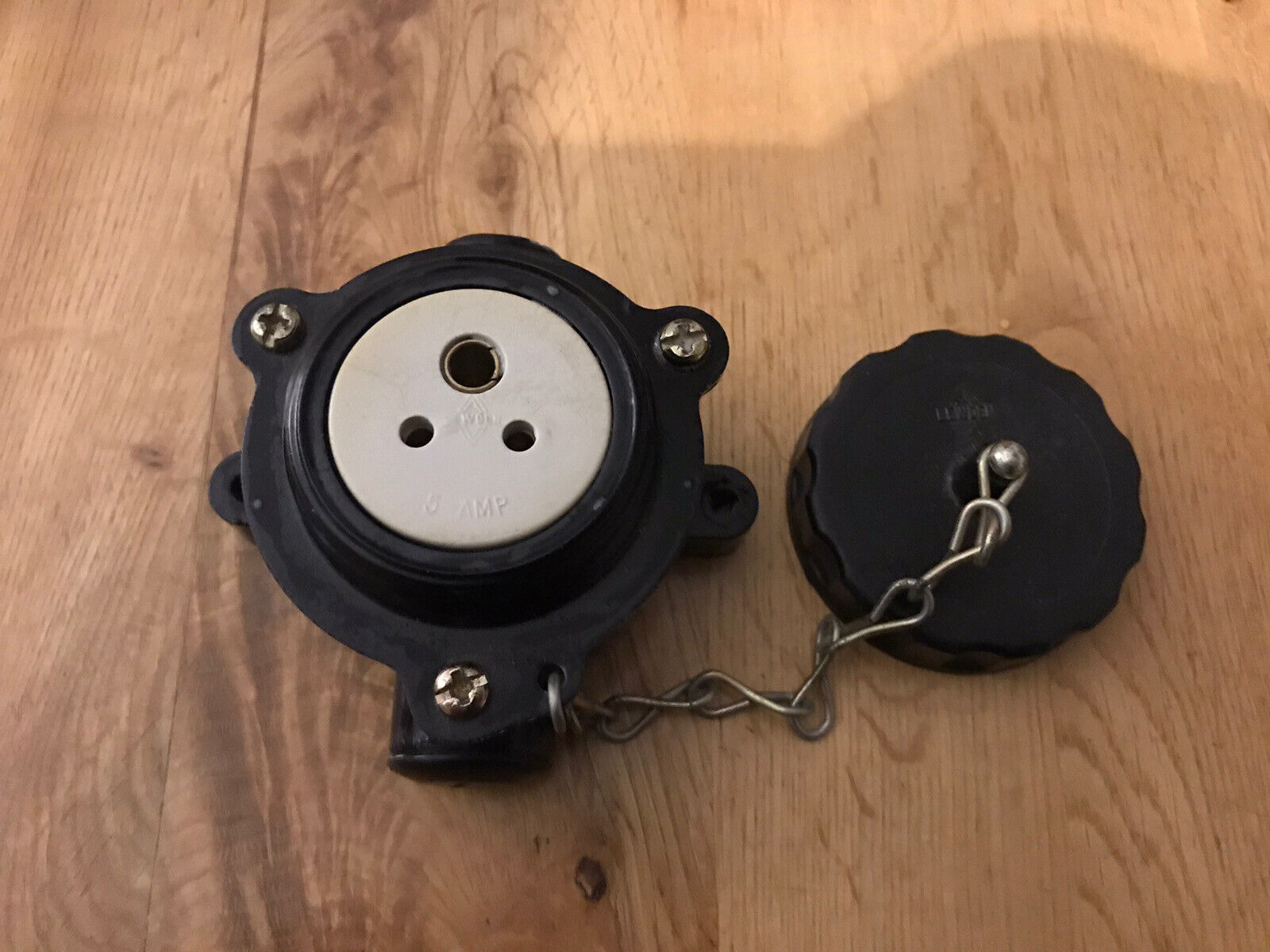

I actually have a lead 2A plug to 16A blue socket which I made up for a particular village fete where the most accessible power source was a light in the church wicker gate and plugged into this style of metal clad socket:
My thanks to Ebay for the image.
