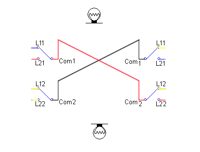

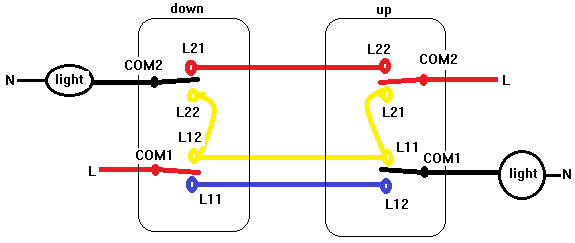

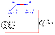

Is @SUNRAY some where close, there are two common methods to wire two way lights, as taught in school View attachment 186960 and more practical View attachment 186961 the school method often needs connector blocks in the switches, but neither seems to fit, so I am looking at a third methods View attachment 186962 if the final method is used, then the challenge is to work out what colours are used for com, in all three diagrams getting L1 and L2 swapped is not really a problem, as long as com is correct. I would has guessed that the red, black is not two way, so simple com and L1, and the red, yellow, blue is two way. However I would start by working out what wires a live feed in, so if I was doing it every wire would go into a block connector and then using a meter work out which is always live.

I think you really need to post drawings or pictures, what you want can be done, it may need some special switch like the kinetic, but it can be done, however everyone on here is struggling to work out what you have.
Clearly a two core and earth plus a three core and earth to each switch plate, but with a normal two way arrangement your missing a three core and earth to each switch plate.
The normal is first two way switch has 5 wires, two wires each into L2 and L3 (new switch numbers) and second two way switch has three wires. Clearly you don't have that, but I have noted some electricians use three core and earth to switches to allow future changes, the third wire could be used for a neutral or for two way switching, but this means more wires joined at the ceiling rose.
In the main a ceiling rose has four blocks of connectors, a clamp for the earth, 2 terminals to connect switched line to pendent, 3 terminals to connect permanent line to switch and next lamp, then 3 terminals to connect neutral to next lamp and pendent. However with two way switching as shown in my diagram you would have another wire in the ceiling rose, which connects the two coms (in new switch L1) together.
We are trying to progress step by step, and first step is to work out what you have,
I tried to work it out from your original description colouring wires and using your numbers, but once coms are connected, nothing lines up, specially the two yellows bottom left switch, which seems clearly wrong would never work if connected together, so what is wrong?
