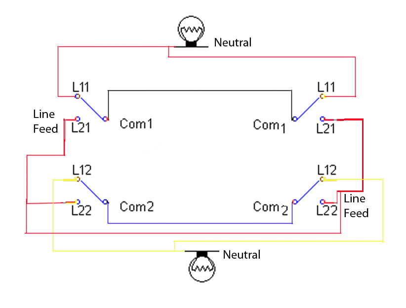

SUNRAY worked out what you have and a way to have both lights on the one two-way set up.

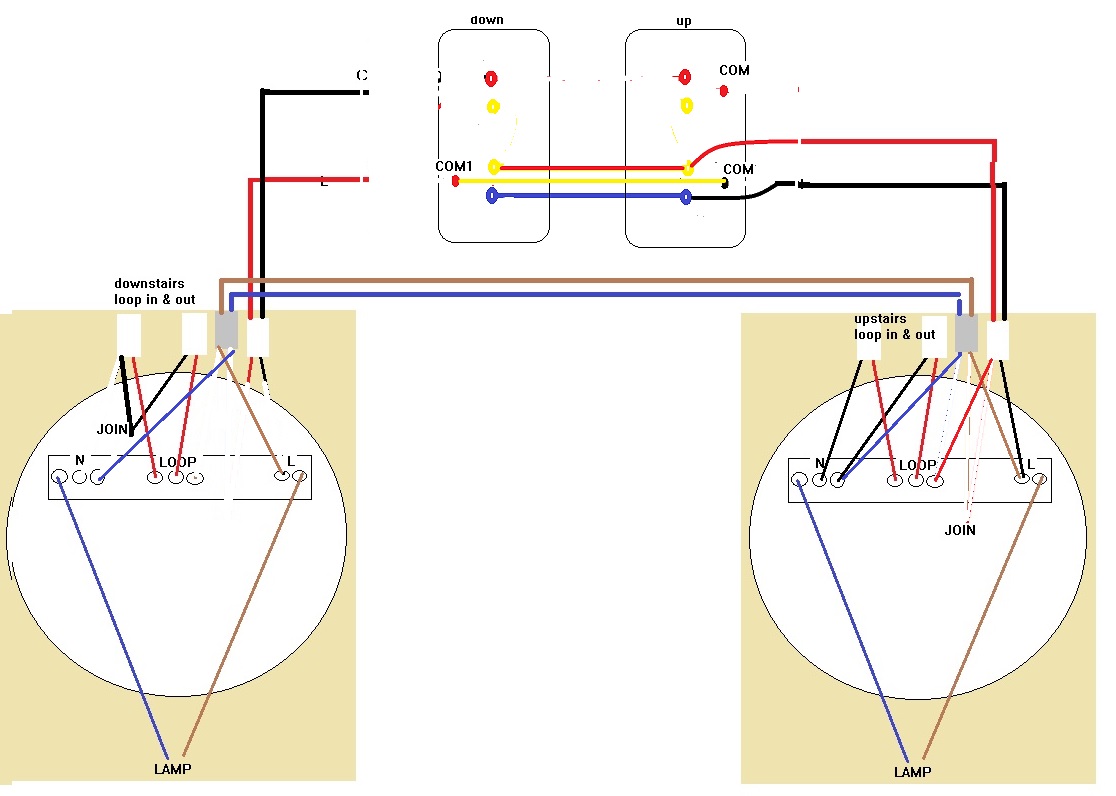

This is what SUNRAY worked out what you originally had:
With what you have done - allowing for the wrong way round two-way downstairs, one-way upstairs instead of two-way upstairs, one-way downstairs.

Which would you prefer?
The normal system of one-way down and two-way up, or
as you suggested both lights on one two-way system, that is only one switch up and down which works both lights?

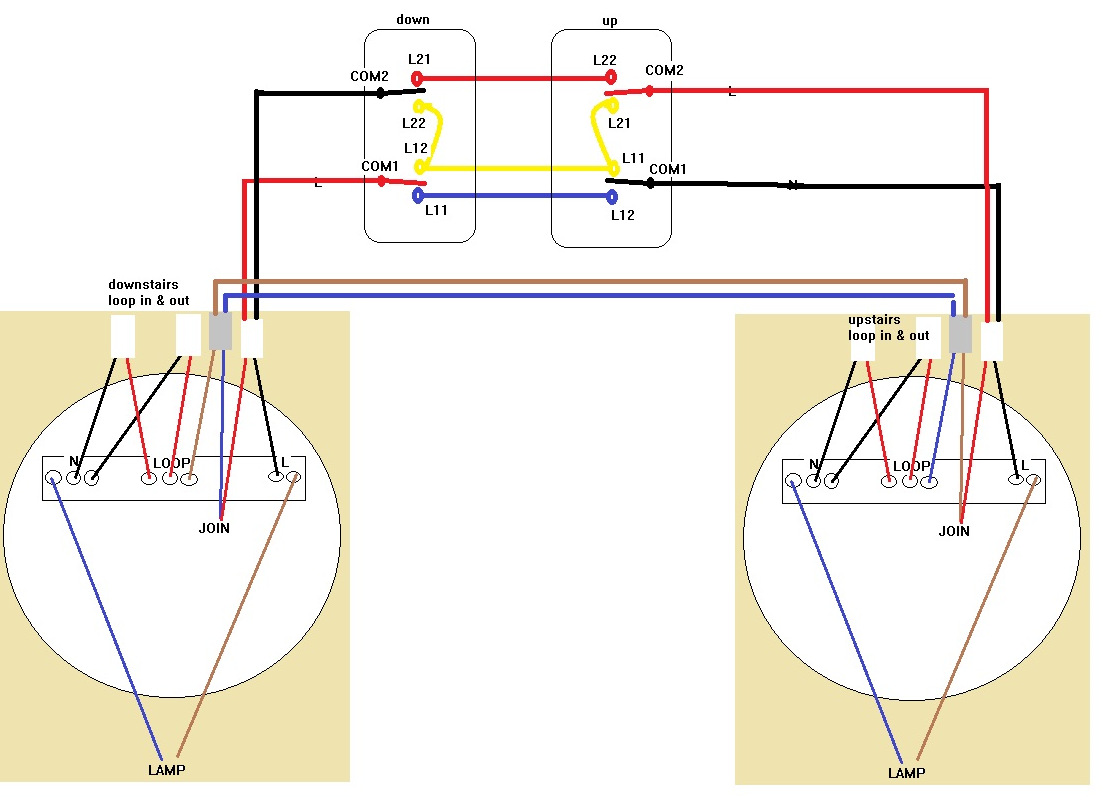

The grey cable is from the upstairs light to the downstairs light not to the switch just as ELFimpudance lovely drawing which is exactly right. Some of the wire have red tape on them.
I have wired the circuit like ELFimpudence suggested yesterday afternoon except it's the downstairs light which we've chosen and I've used different colours. As the light shines through the spindles onto both parts of the stairs and the upstairs light doesn't shine on the bottom part.

When I measured the volts with my neon tester I worked out the grey cable provided the downstairs light power to the upstairs switch and the upstairs light power to the downstairs switch but removing it and connecting red to loop instead of the grey cable and then wiring the red black as your drawing for a single switch in both switches made the lights come on properly without being dim like before. Then I wired the 3 core like your drawing but for the downstairs light.
Your drawing of the whole system is exactly how it was to start and now I see that I can see why the lights could get stuck on with both downstairs switches down. The grey cable isn't connected to anything now

Credit to SUNRAY for the diagram. It wasn't mine.
SUNRAY's drawing of the whole system is exactly how it was to start and now I see that I can see why the lights could get stuck on with both downstairs switches down. The grey cable isn't connected to anything now

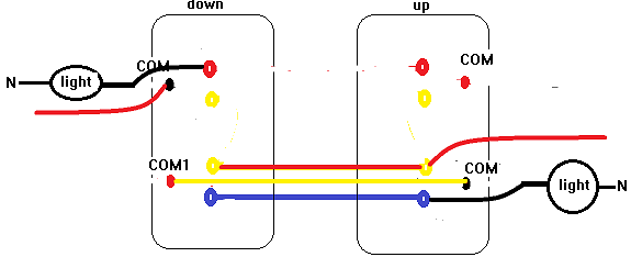

Another diagram SUNRAY prepared yesterday.
You need to do this:

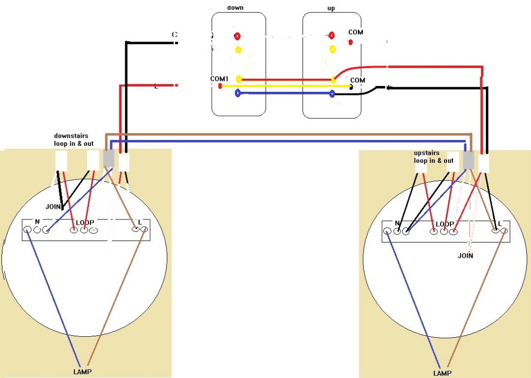

I did this with the expectation of the start point being upstairs but if you simply flip the up's and down's it'll be your system:
All it does is link the 2 lights together using the existing grey cable.
You will need to take the existing black wires from the N terminal and disconnect both ends of the red and black of the switch cable.
Make sure you leave the earth wire in place as the 3 core doesn't have an earth.
