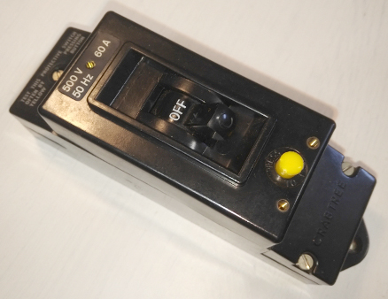

Hello chaps
I have an old CU that I want to replace with a modern unit. This is a TT system with an earth spike driven into the ground and a voltage operated earth leakage device installed.
My question is on the new installation can I just leave that VOELCB in place so that I don't have to call in the network operator to pull the main fuse.
Thanks in advance - Stuart

I did, the only down side is likely rated 60 amp, so if you want a larger isolator latter it will need renewing, and the earth rod will now by-pass the unit. I assume something like this ELCB-v.jpg without the centre wires, it is just an isolator like any other.

As you've been told (and probably already knew) you cannot, and should not, retain the VOELCB functionality as an attempt at 'protection' of your installation and I presume that the modern CU you wish to install will include proper RCD or RCBO protection.
However, if you remove the connection between the VOELCB and the house's earth system, then it will simply become a 'manual isolator'. Hence, IF the (presumably aged) VOELCB is still effective/safe as an isolator, then I would see no theoretical reason why you could not do what you suggest.
The VOELCB probably ought to be eventually changed to a modern isolator, both for reassurance about reliability and because it may well not have a high enough current rating for your present needs. Until such a change were made you would probably need to be prepared for discussions/arguments with anyone inspecting the installation about the presence of the VOELCB (which they may not understand!).

Ericmark - The VOELCB looks similar to the photo. Yes you are right about the rating as the ceramic main fuse holder is embossed 60 amp. No EV charger without an upgrade.
No, it's obsolete and should have been removed decades ago.
It's not suitable for it's original purpose, and it can't be used as an isolator either.

As I said (with all my original emphasis), "IF" it still remains satisfactory as an isolator, I see no reason why it can't be used as such - and whether or not it achieves satisfactory isolation is something that would need to be verified ('checking for dead') even if it were a brand new isolator - so, provided that is done, I see no 'safety' issue.
The situation Sunray describes is exactly what I inherited when I moved into my present house. The connection from CPCs/MET to the installation side of the VOELCB had been removed, but the device itself left there as an isolator.

Thanks for that John. I do understand that to do this is not best practice but was looking for confirmation that what I was proposing was actually safe.
You're welcome. As you will understand, that's how I took your question and was the spirit in which I answered. As one might expect, others have felt it more appropriate to point out that, in addition to not being 'best practice', it is also probably non-compliant with current regulations (BS7671), and have used that to imply that you shouldn't do it - but I suspect you already knew all that.
As for safety, as I've pointed out, even if it were a spanking new modern isolator, good practice and common sense (and a desire for self-preservation!) would demand that, after 'switching it off', you undertook recognised "testing for dead" to confirm that things downstream of it were no longer life. If such tests confirm 'dead' after you switch off the VOELCB then, even though it is an ancient switch mechanism, it is (at least, in my opinion) all-but-impossible that it would suddenly 'switch itself back on' again. However, I'm sure that you understand all this, and will come to your own decision as you see fit.
Kind Regards, John
What testing for dead won't tell you is whether contacts are seperated by an appropriate isolation gap, or whether they are just barely not touching, and are a bit of vibration away from touching again. A well-designed isolator will be designed such that the switch position provides a positive indication of the position of the contacts.
