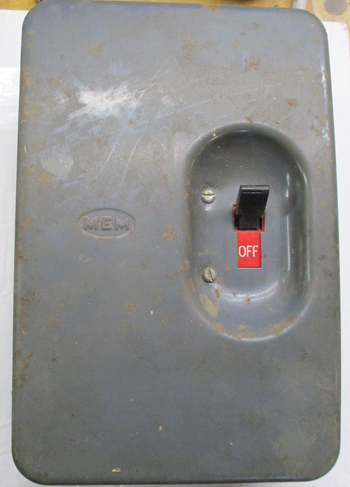

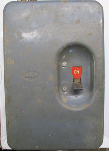

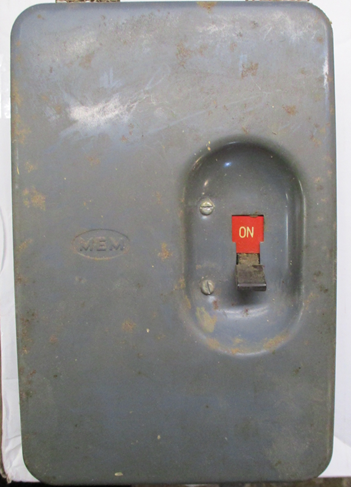

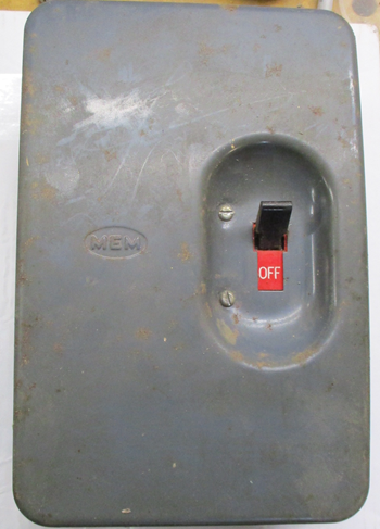

Quite so, in general - at least in this country and in 'recent'(decades) times, but by no means always. The switchfuses feeding the distribution circuits I inherited in my house were enormous MEM things,of which this was one ..
I don't recall working on more than one with the cover off but that one had a double contact, ie a pivoting bar that made contact at both ends and a substaantialspring, it required pushing a locking button to allow it to be switched on and almost a hair trigger to flick it off. I feel the contact separation would have easily been ½" twice.
As I said, albeit on the basis of relatively little experience, I've got the impression that 'ancient' switchgear tended to have 'fairly massive' contact separation.
Kind Regards, John
.View attachment 293086View attachment 293087
Kind Regards, John

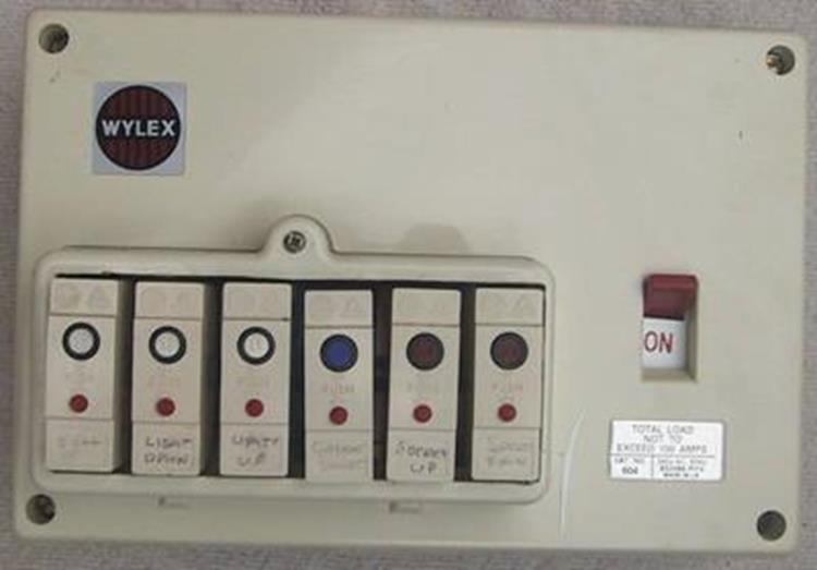

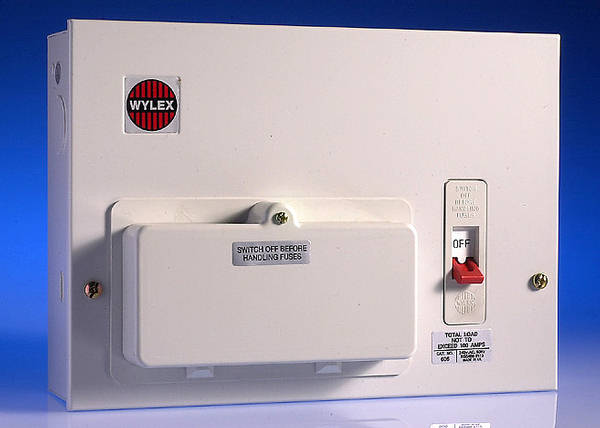

I had one of those when I moved into this house; 2x 30A cooker and ring, 2x 5A lights, original from 1965. Added to that a couple of single wylexes; 30A for shower, 45A submain to granny annex.
I actually thought about the wylex boxes after posting, where the main switches are 'up off' but the RCD mains switch version was 'up on'
However to add to the confusion that did change at some point and I did have one of each in my home

3) Remove the wired fuses from the old Wylex box and fit miniature circuit breakers in their place.
People may argue, but that would not to my mind represent 'replacing a consumer unit' which is the only relevant thing that would be notifiable.
However, as I suspect you realise, aside from the issue of isolation (which we have discussed at length), to add an RCD and replace the fuses with MCBs is far from the ideal way to go - you should really replace the Wylex box with a modern CU (which has built in RCD protection plus other things) - but that would indisputably be notifiable work.
