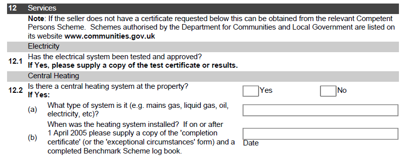

Don't show it to them then. Unless they ask if you've had the electrics inspected - now that you have you'll have to say so.
Indeed, but even if they did ask (which, as I said, I don't think the standard conveyancing forms do), I don't think it would be appropriate (or even 'legally safe') to hand over this EICR without comment ...
... let's face it, if a seller had reason to believe (on the basis of the opinions of other electricians) that an EICR was incorrect, perhaps even fraudulent, in a manner which was potentially in favour of the seller, then I would think that there would be a legal obligation not to simply hand over that EICR 'without comment'. If that the case when the errors/frauds are potentially in the sellers's favour, I would suspect that the same would probably be true in the converse situation - either way, if one simply 'handed over the EICR' one would be doing something which one had reason to believe could mislead the buyer.
Would an EICR come under the "Have you had any electrical work carried out since 2005?" necessitating an answer of "Yes"?
Indeed, but even if they did ask (which, as I said, I don't think the standard conveyancing forms do)...
It seems that I was at least partially wrong in my recollection, but the version of a TA6 conveyancing form I have to hand has no Yes/No boxes for the question, so it's actually impossible to answer "Yes" :) ...
However, I still remain of the opinion that to simply 'hand over' an EICR which one had good reason to believe was probably incorrect and misleading as regards the state of the electrical installation would not be appropriate (or, necessarily, 'legally safe').
Kind Regards, John
I doubt it - not the least because, as we've discussed before, I think most people probably interpret that question as relating only to notifiable work (since, otherwise, the documents requested on the form would not exist) - and an EICR is certainly not 'notifiable' :)
How about accepting the opinion of several disinterested people that the report provided was so egregiously flawed that it would be quite justifiable to take the position that it has not been tested and approved?
Yep, that sounds reasonable. I suppose that someone wanting give give 'full disclosure' could do just that - admit that the inspection has taken place, but that the report had been 'discarded' because several disinterested people had given their opinions that it was seriously flawed and hence misleading.
Yes, the full disclosure you suggest is probably what I would go with. Although ideally I'd like the money I have already paid to result in a revised and accurate EICR.
... admit that the inspection has taken place, but that the report had been 'discarded' because several disinterested people had given their opinions that it was seriously flawed and hence misleading.
... and the fact that the 'inspector' was only on the premises for 30 minutes, so de facto could not have carried out the full required testing procedure.

Yes, the full disclosure you suggest is probably what I would go with. ...
Fair enough. It would clearly be 'wrong' for you to make use of an EICR which you believed was incorrect/misleading 'in your favour', so I don't see why it would be any less 'wrong' to facilitate a buyer making use of an EICR which you believed was 'incorrect in their favour'.
