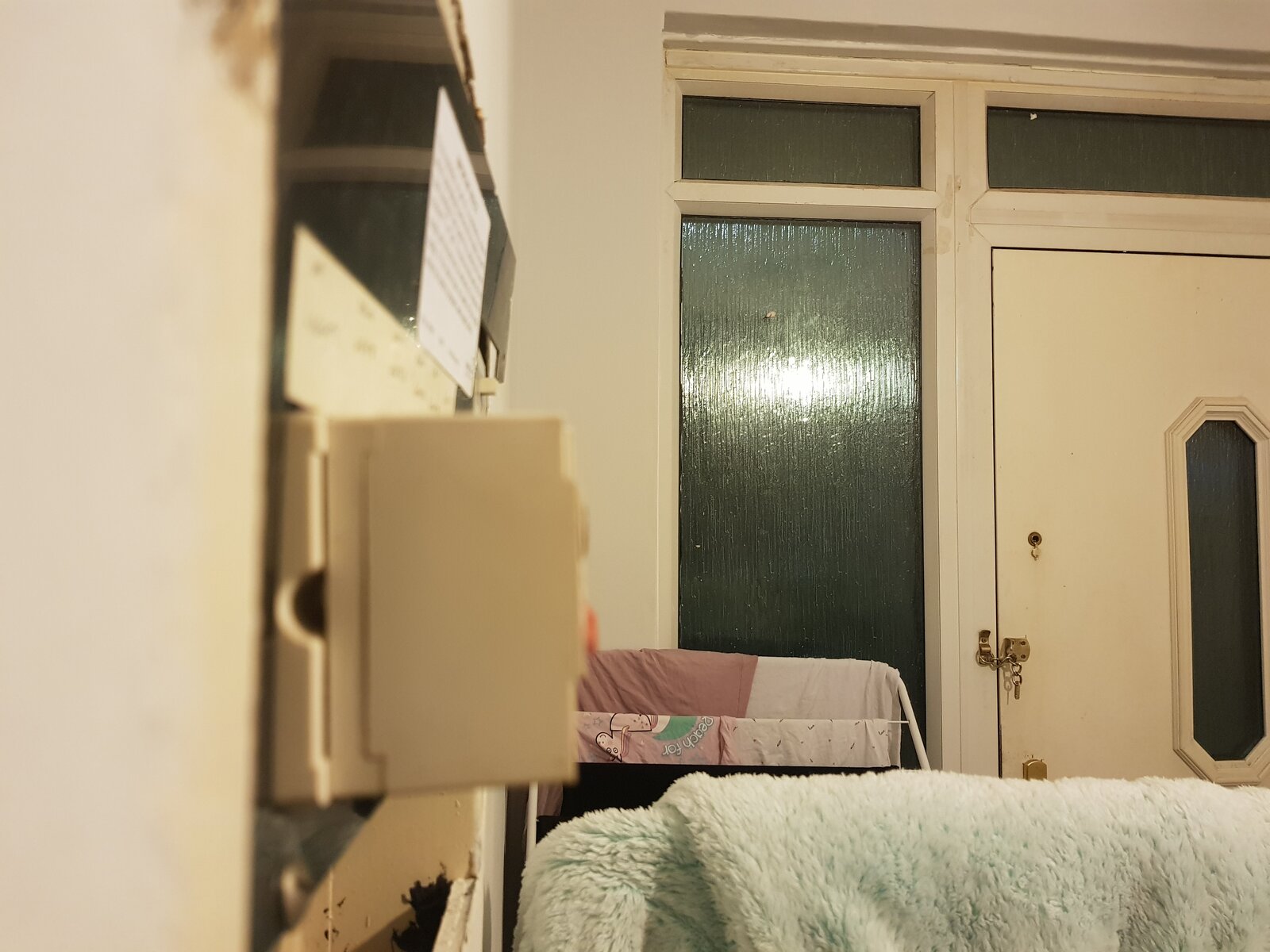

AND not all of those cabinets are fitted with the extended front and that board protrudes beyond the front of the flush finished version.

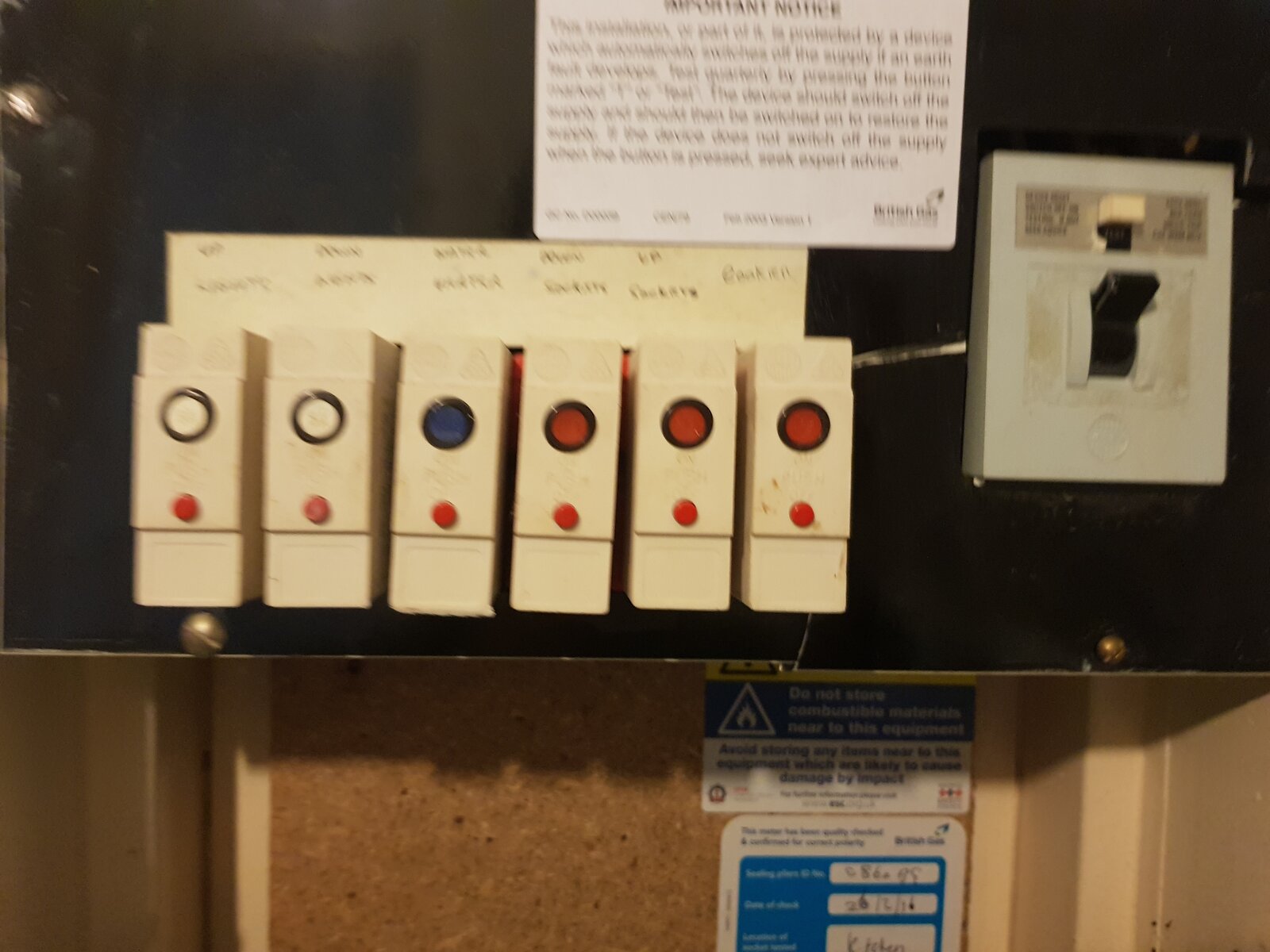

No mine looks older than that video. His one had flick switches mines push putton lool

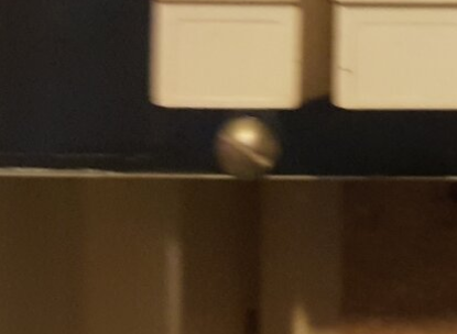

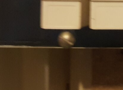

Never seen a Wylex board with screws like that.
As regards age, a brown Wylex consumer unit with a wooden back plate could have been installed as early as 1956. But there would be other clues if this were the case, like the presence of rubber cabling.
Having said that, I have seen several rewires over the years where the consumer unit was not replaced!
I believe that style of RCD was among the first to be installed in consumer units. AFAIK, they were introduced in 1974, but their take-up was very slow.
Ivory consumer units were being installed as late as the mid 1980's and some of those had wooden back plates.

I believe the screw is fairly typical of the Maintal [very likely the wrong spelling] enclosures and not all of them had Wylex inserts.
I fitted a cream Wylex in the current house around 1994, the wooden versions only had a frame, the mount with a ply back was an extra or at least not the basic version. I believe the wooden version was phased out and around 1982/3 as I purchased an 8W and a 4W and got a wooden and a plastic version.
Not really. My late parents house was built in 1952 and had PVC cabling from the outset.
Ok, fair enough. But, in the same way as rubber cable was still "allowable" under the 14th Edition (iss.1966), but very rarely seen in installations after that date (I personally have never seen rubber cable in a house wired under the 14th), PVC cable appears as an option in the 13th Edition (iss.1955). I can't speak for the 12th Edition (iss.1950, the regs in force when that house was built), as I don't yet own a copy.
Sure, but I have never seen the screws on the front, only at the sides of the skel unit. As RF says, every day's a school day!
Some of those units are basically a flat plate screwd onto the edge strip and the partition.
