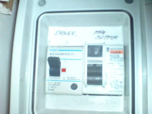

The first thing I saw was this:

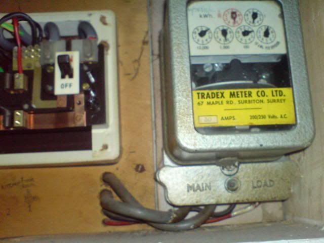

The second thing I saw was this:

I hope you kept your hands in your pockets :shock:

Top one, two RCDs? No overcurrent protection?
2nd one, the cables leaving the meter are a bit tiny

:? in pic 2 it looks like the Wylex is connected to the "main" side of the meter... and those weedy tails are on the "Load" side. Or am I confused by the tails disappearing behind the board?

Yes, the shower appears to have two rcd's "protecting" it and no cpd.
The Wylex cover I took off.
The 16mm² tails in the CU are connected to "MAIN" and the thinner tails (the supply from that dist. cabinet) to "LOAD".

A guy had been out to fit a few sockets and had failed (miserably) to tighten up the neutrals at all. The screws were so loose, they were almost falling out of the 'bar.
This had unsurprisingly, caused heat to build up, burning the wiring and tracking back through the main switch. You can't see at all in the pics, but around the screws that hold the CU innards to the wooden frame, there is lots of goo; broken down bakelite (or whatever it is) due to excessive heat build-up.
