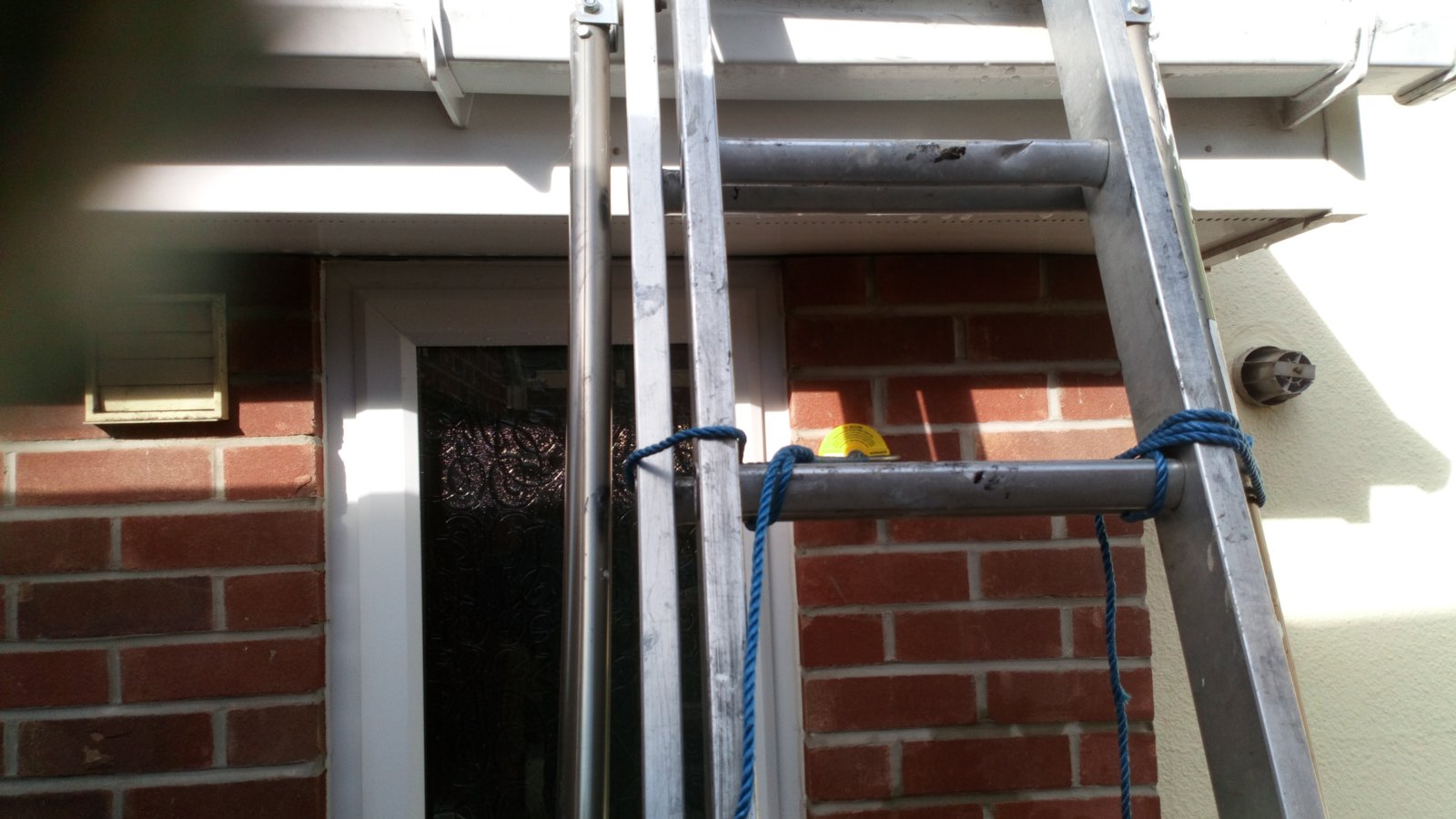

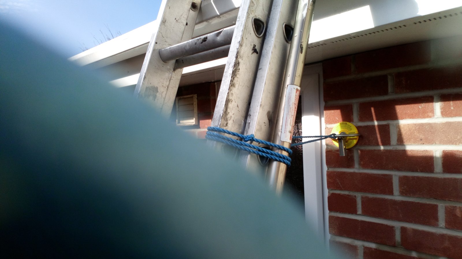

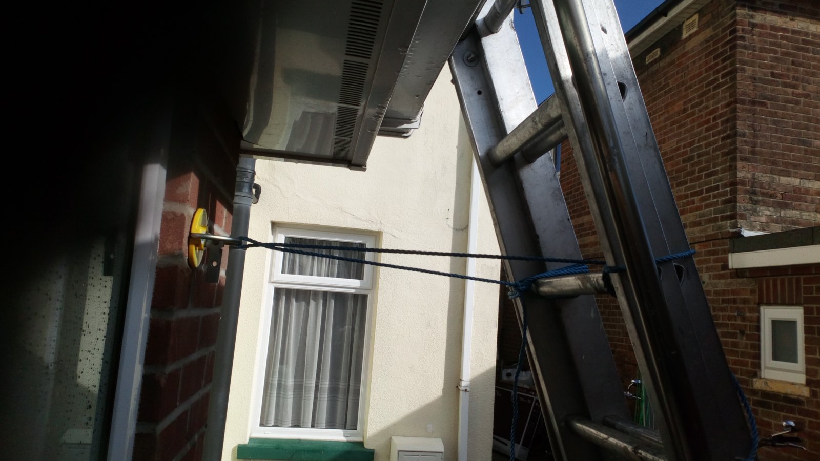

Just checking my tying a ladder is OK. I found that in both cases the top slides a bit left to right. One is on a wall going onto roof and one on a tower

Those towers are designed to be climbed on the inside
It is far easier and safer
Yeah you shouldn't have the ladder on the outside of a tower even with riggers.

Tie off the Tower just above ground floor level , The stabilisers can move which will make the Tower unsafe

Your idea of wrapping the rope around the anchor point is not sufficient, the rope can move or slide around it.
Learn some decent knots and hitches and tie it more securely.
Which knots would you recommend tying to stile and anchor?
