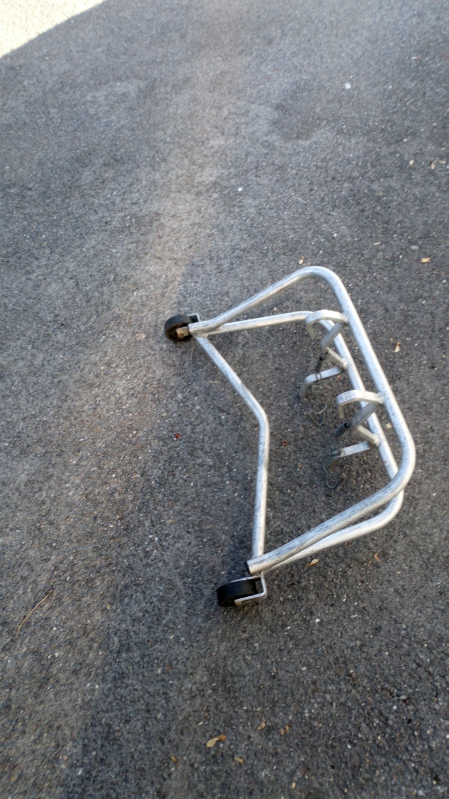

One of the few rungs visible looks damaged.What's wrong with other ladder? A bit of paint doesn't make a trade Titan Classic ladder a bad ladder. It's a great ladder.

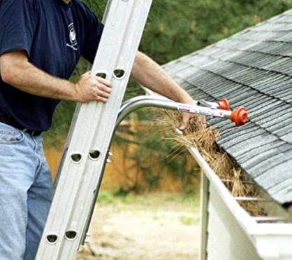

Standoff and tied in at the top.So how would you put a ladder against a gutter then when getting on a roof?

You just go up with a chunk of 100mm x 50mm timber and wedge it in the gutter.
So you do put it against the gutter.Standoff and tied in at the top.
Eh?And pray no-one falls, otherwise you (as the employer) are fooked.
with a standoff?So you do put it against the gutter.![]()
Obvs. And tied if you fancy it.with a standoff?
Bit silly to say this really.6) Resting a ladder on a gutter is a no-no.
Use a stand off.I wonder what Brigs alternative is.....?
