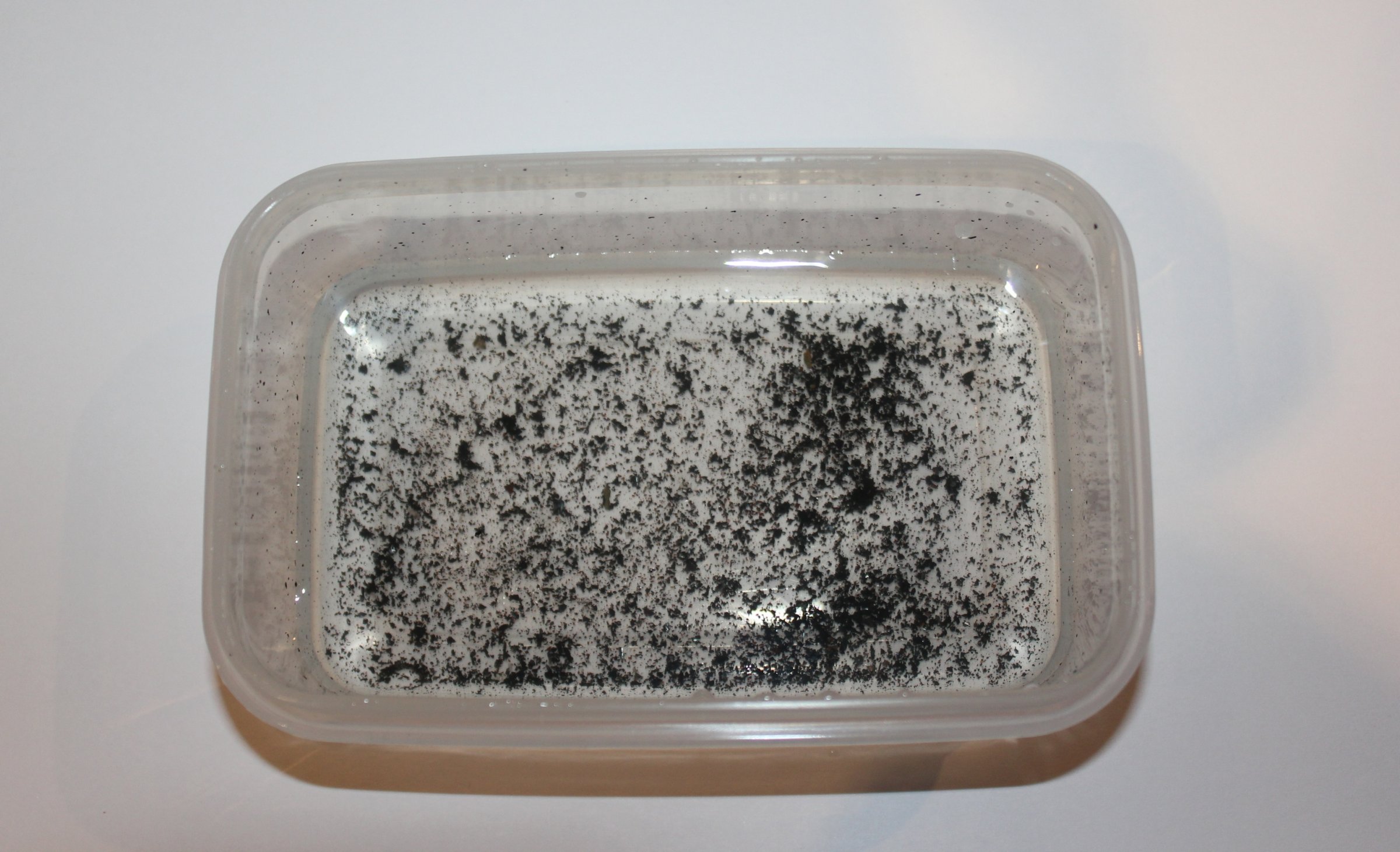

Been doing minor work to my Central heating system consisting of replacing one single radiator for a double one (same width and height) along with refitting a another poorly fitted radiator which brackets were loose and wonky.
When I drained the radiators, small black particles came out what are magnetic:
Black particles:
My System is a modern Vaillent EcoTech Plus 937 boiler along with 10 radiators, three of which are reused old ones from when I first moved in, the rest of which are a few years old.
My question is; in addition to me flushing my system with Sentinel X800 followed by using the Sentinel X100 Inhibitor what I shall do in the next couple of days, is it also worth fitting one of these magnetic filters? (i.e. Fernon TF1 Total Filter, etc...)

I'd avoid the TF1 it will leak at some stage.
My preferred filter is the spirotech MB3
I'd also avoid x800 unless u are using a proper power flush machine.
If x800 is not 100% removed it can cause issues with sticking pumps.

I was only using the TF1 as an example; never had a magnetic filter before so don't know if it's worth it. I have a unused radiator point in my kitchen (15mm supply & return) for a radiator that was designed in but never fitted, could I attach a magnetic filter here or does it need to go as close to the boiler flow return as possible?
U want the filter on the return pipe ideally as close as possible to the boiler.

That makes sense to have it on the return before the boilers heat exchanger, but is it really worth it once I have cleaned and inhibited the system. After all my old CH system at my old house with 18 radiators what was un-vented did not have a magnetic filter, and if it was that important, then surely one would have been fitted when my boiler was installed 3 years ago.
Entirely up to u.
I fit one on every boiler I install.
They are not expensive and are easy to install
I cleaned out my system a couple of years ago using Sentinel x400 and then fitted the Spirotech MB3 before refilling. The Spirotech MB3 may not be as effective as the Magnaclean but it is a solid piece of kit.
I drain the filter twice a year (and top up the FE tank with a small shot of inhibitor once a year) and on each drain I get a small but lessening amount of rust. In other words you'll never get 100% of the rust out by manual cleaning, the filter is a good insurance to keep the rust from building up elsewhere that may cause damage or blockages.

If the system is really clean then a magnetic filter is not necessary. After all they have only been popular for the last 10 years or so.
I have found that many installers don't do a proper cleaning job and just rely on the magnetic filter to do the job.
It is only the boilers with plate heat exchangers which are very susceptible to dirt in the system.
